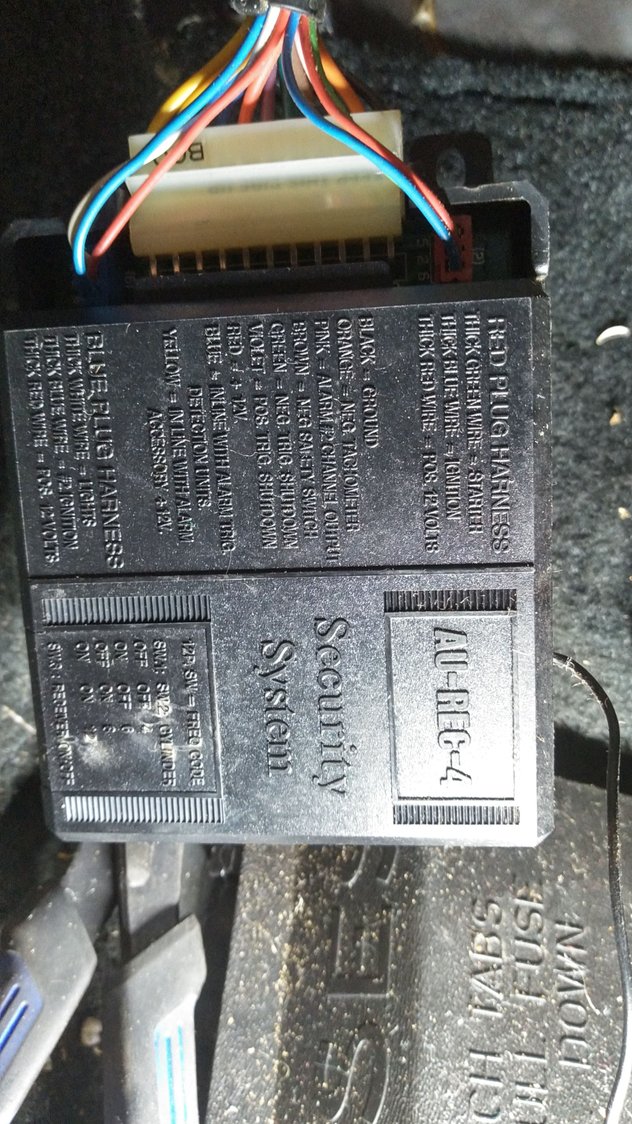

Just a follow up with this post. I finally had a chance to track where this orange wire went. It ended up going to a security box someone had installed before I bought the car 20 years ago. I never knew it was there and never had a remote to run it. I decided to remove it as the internet is full of stories where these things go bad. So after hours of tracking down wires I cut it out and returned everything back to stock as far as I can tell.

I had an aftermarket system....It was garbage...it made the under dash look worse than a rats nest lol Pulled out and never looked back.

I agree, it was all wire tied to everything. My power door locks still don't work but everything else seems fine. I hate dealing with wiring!
