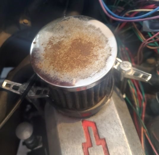

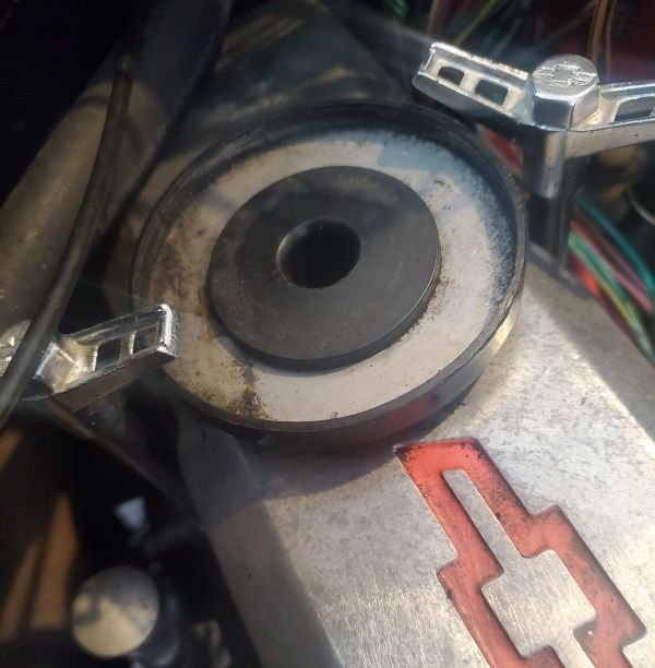

Lol, yep, I can't get this valve cover breather off and I don't want to ruin something else while trying. I've tried twisting and pulling. Anyone have this kind and can shed some light on how to remove it to replace it? Thanks! Oh, I'm trying not to take the valve cover off. :-)

Not familiar with how that's attached, but I'd be mighty tempted to take the valve cover off to find out.

Well, yes, but like I said, I'm trying not to because it's a pain to take off. With all the wiring and such, you have to really finagle it and I know it's gotta be something simple. I guess I'll just keep working on it.

By the time you figure it out, you could have had the valve cover off and back on 10 times. That's a trap that many amateurs get themselves into - it's typically much faster and more effective to just remove whatever is in your way (in this case the stuff blocking you from easily removing the valve cover, etc) than to wring your hands and gnash your teeth and post on the internet about it for a week.

Looks like any regular push in breather. Grommet probably hardened from heat and wont let go. Pry up evenly on both sides and see if it pops off. Or a 5lb slide hammer attached to it would do the trick.

Try to soften the rubber with a heat gun or hair dryer.

Or just run the engine lol

I'd be concerned that forcing it out may cause the grommet to break apart and leave fragments on top the cylinder head.
Pull the cover off...

Probably the rubber grommet has turned to concrete. It's EFFFFED.
Use more force. Maybe one of those wide prybars from underneath, with a piece of plywood or something to protect the valve cover.
If it breaks, you already know you already needed a new one anyway; why worry?

So it was a pull off type. Yes, I ended up taking the cover off. Thanks everyone for your suggestions.
