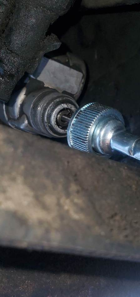

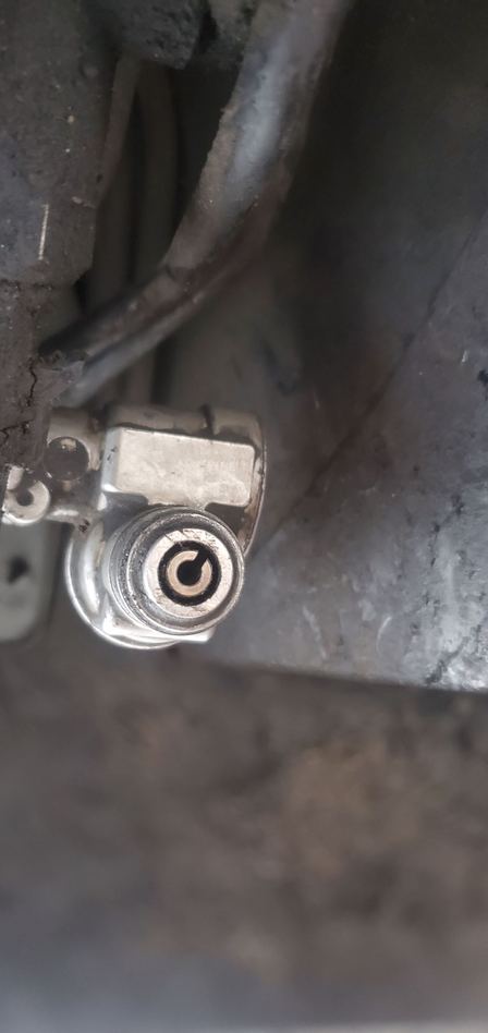

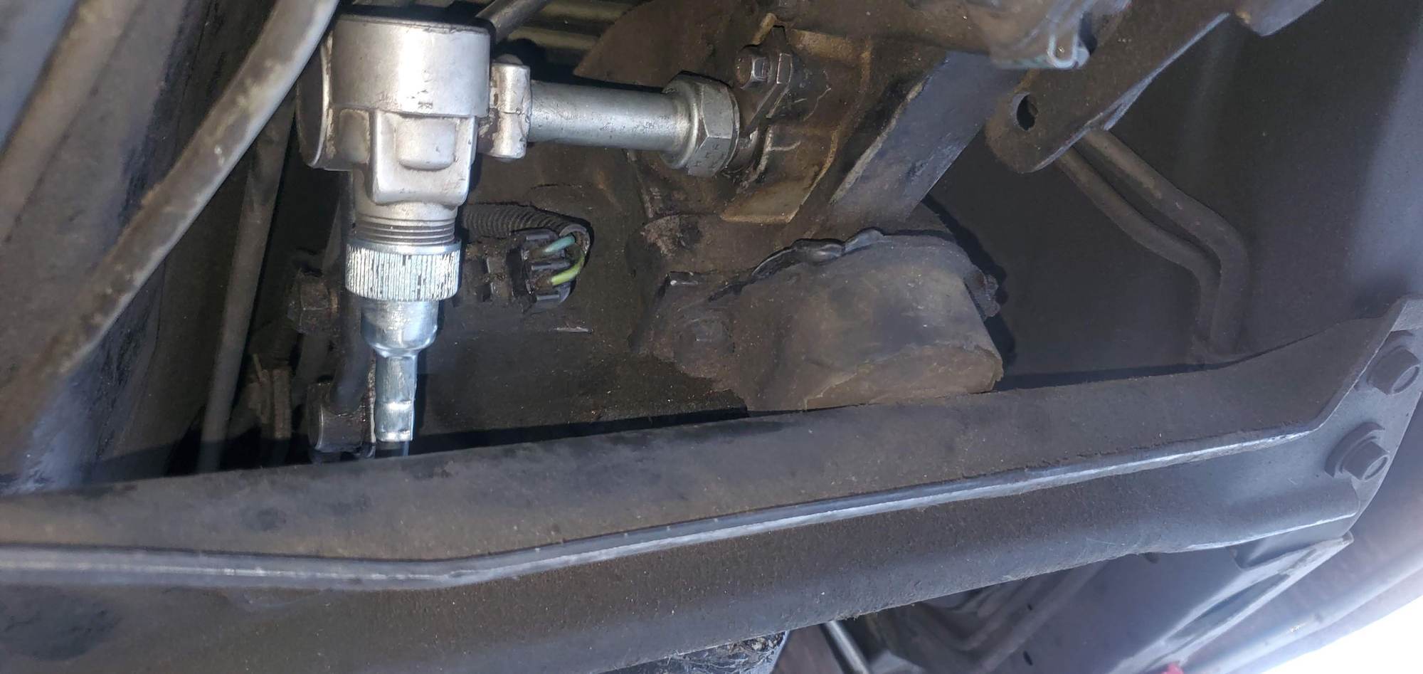

Hey folks, junior member here. Just picked up an 82 trans am with the 4 speed. Spent a good part of the day troubleshooting an inopt speedometer. The upper cable is good, the actual speedometer works when tested with a drill, and the transducer checked out. (cruise control car) Speedo gear is fine too. The problem is lower cable is not rotating. Coming out of the transmission is a speedo gear housing that has a 90 deg bend in it to better meet up with the cable I guess (1st picture). The female end of the housing (2nd picture) is rounded, not squared, but has a key slot. The smaller, squared speedo cable just floats in there and doesn't get any rotation (3rd picture). Not sure if the housing is missing an insert or something. I did find an adaptor with GM part # 88961013 on Amazon that looks like it might work, but not sure. Thanks
90 degree speedo gear housing
Keyed female connection where lower speedo cable attaches
Speedo cable floating in housing
