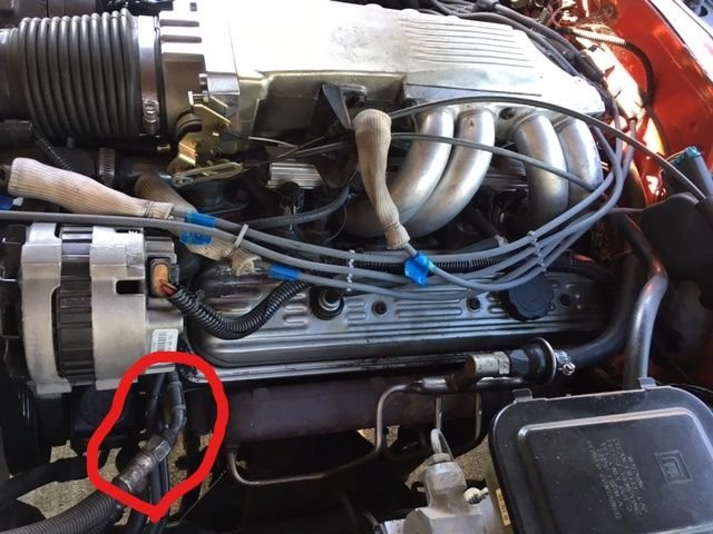

Identify some hoses
Need some help identify the pressurized hose above. There is one underneath the red outlined hose next to the shadow of the hose going into the power steering pump.
This project started 5 years ago and can't remember where these hoses go with new engine in.

Fuel lines, the larger one is the pressure line feeding the fuel rails, the other smaller one is the return from the fuel pressure regulator back to the fuel tank......

Thanks. I didn't have the fuel rails on the engine so after digging them, make sense.
