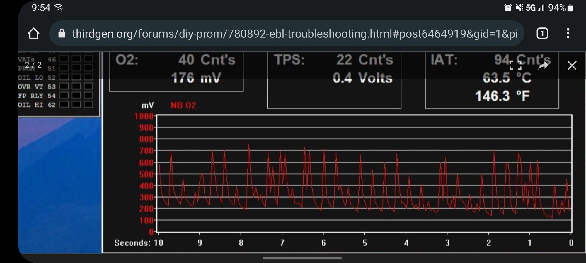

Stealth ram intake. 383. Runs good otherwise. If I progressively press the pedal to WOT the problem doesn't exist. However if I go WOT instantaneously the car completely shuts off for a split second and then picks back up. No SES lights, nothing. I have the EBL ECM from EFIdynamics. I datalogged it to see but it tells me nothing. It appears in the laptop that the car is completely shut off during that 1/2 second. This problem appeared out of nowhere so I have my doubts that it has anything to do with the tune. Loading the parts cannon... I have changed...

Narrow band blues. However I did notice in the datalog that the readings from the O2 are very erratic during normal ops.

Re: Loses all power for 1/2 second when snpping to WOT
Erratic as in goes back to .450mv at idle ?
Not sure how your able to tune wot targeting .950mv or so ?
might try adding fuel for pump shot to see if that helps with it not falling on its face.
a wideband is a inexpensive necessary tool to have.
