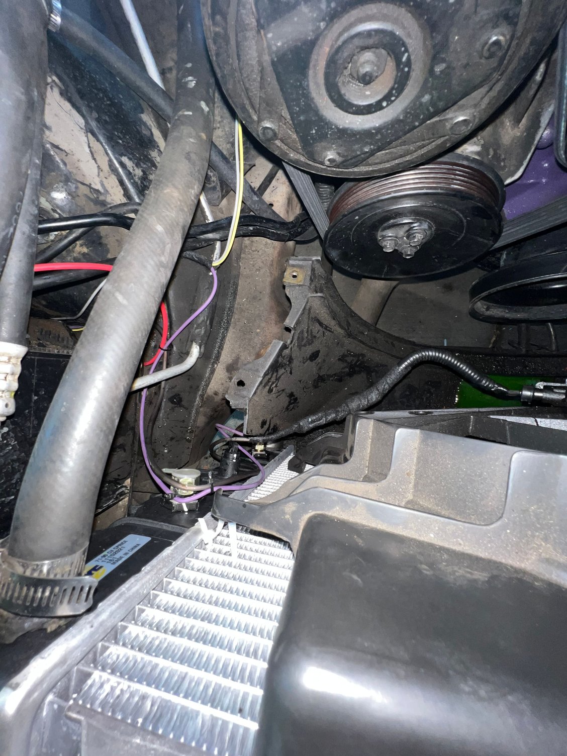

Posts: 12
Re: my car is eating water pumps.
alright yall, thanks for helping my bbody havin ***. this should be my last post on this thread.
i was gonna just grab a junkyard fan and a relay kit cause i'm scared to death of a fan and clutch now, but since i already have a new fan coming in, i'm going to get a new clutch. the only thing coming off the old fan setup will be the spacer if i need it. does anyone think a fan clutch spacer is dangerous in any way for a waterpump?
i started it up a few times and the pump is still in tact. the pump is purple, so my engine is halloween themed for now

found a 97 tbird fan and got it together. ran it to temp and the fan cut on!
it's a lil ghetto just to get it running. i tried my best to make the wiring safe
should be able to leave my trans and rear end on woodward tomorrow. i got the one wheel peel but i'll still have some fun

Hard to tell from the pic, but does the back of that water pump sit nearly right up against the timing cover?
Also, is that pump reverse rotation? The v-belt setup rotates clockwise, multi-ribbed flat belt rotates CCW.

it's reverse and it ain't as close as it looks. i drove it around.
