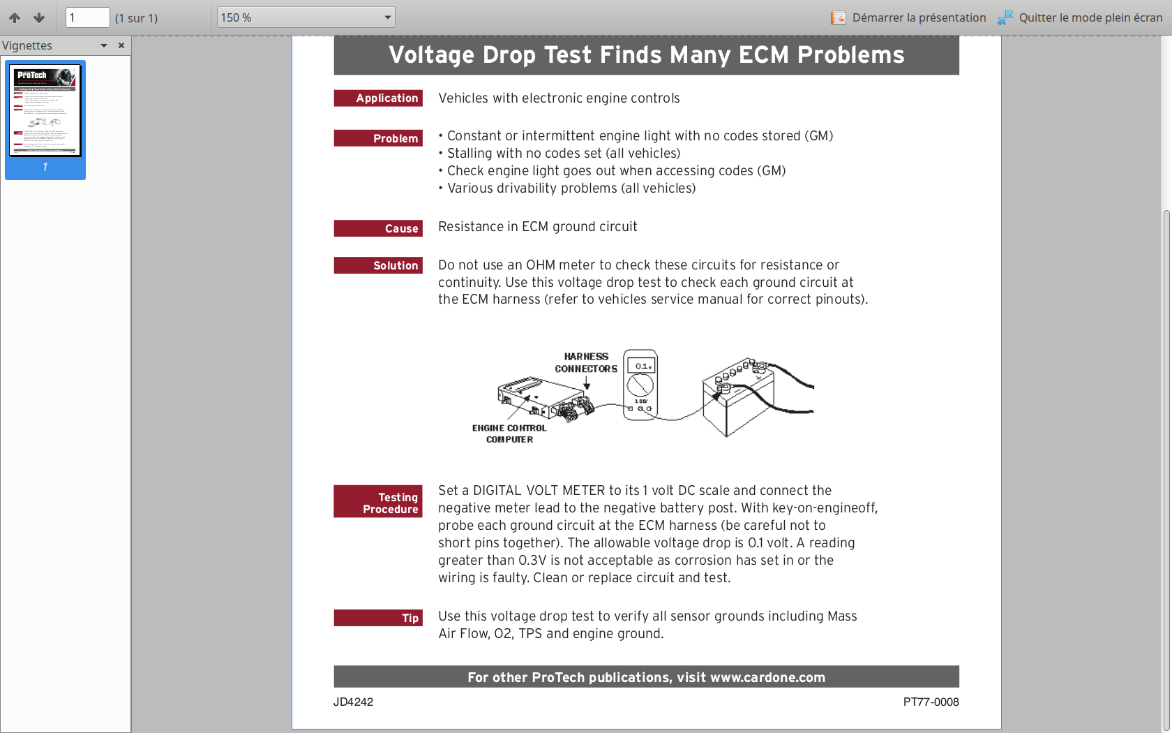

Thank you for your answer. I'll try the grounds this week. I found an interesting way to check the grounds. I put the photo which explain the way to do. A friend of mine who is an industrial electritian know this method and told me that is a good way to do. I'll try to put a parallel light on the 12 v feed of the coil, to see if the light switch off when the engine stall or not. This will avoid or not a problem with the ignition switch or anti theft system. I'll tell you the results. I'll tell you the results.

As I told you, I tried this week to find what is the problem on my Camaro. I checked the wires to find frayed ones and harness to find pins coming off. All seems OK.
I checked all the engines, ECM, 02, TPS etc.. grounds with the method with volt meter (see the sheet voltage drop test upper). The worse ground was 0.075 V, and the better one was 0.03. As they need to be around 0.1 V, all is OK from this side. I checked all the vacuum hose, without seeing anything wrong.

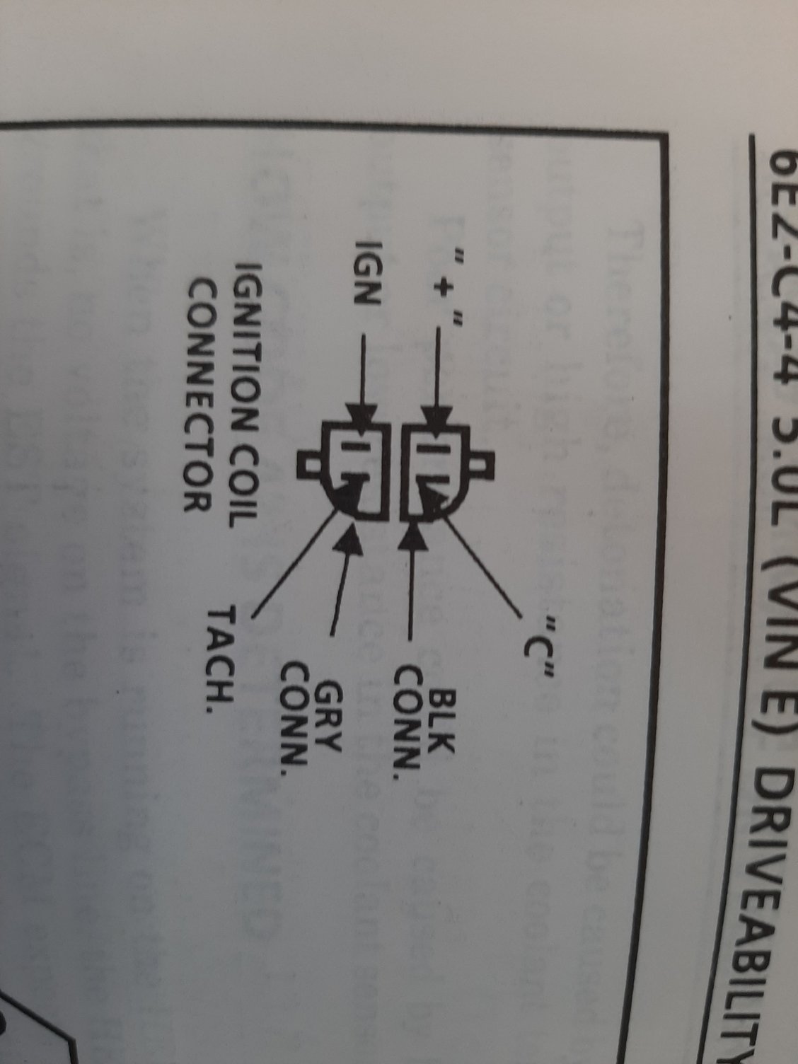

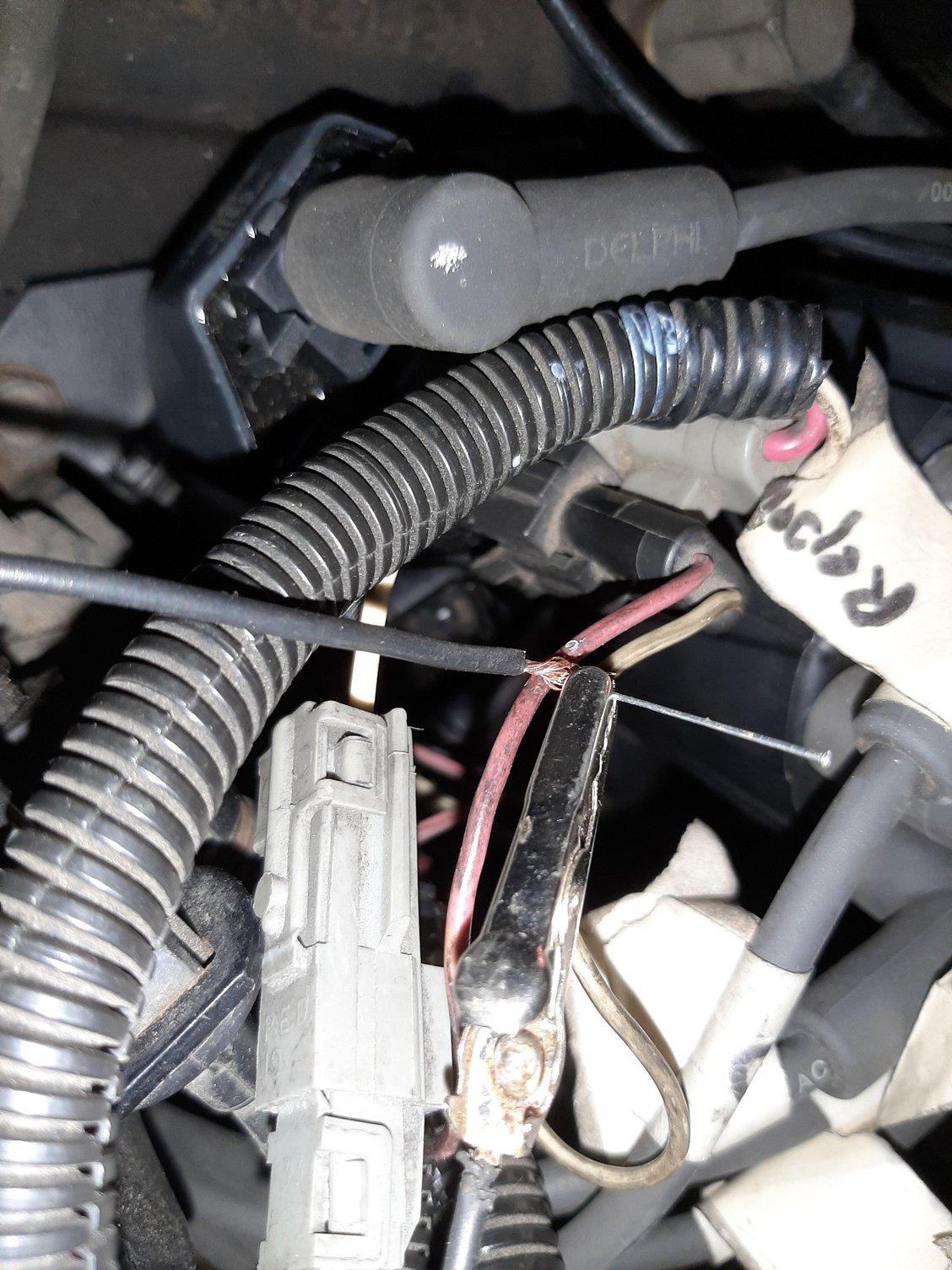

I came back to work on my car. I tested the TPS like you told me, without finding anything. It runs well. I checked the positive feed of the coil with this method:
I made a mounting with a relay and a light test to see if the feed cuts when the engine stall. The advantage to use a relay with the schema I join, is that if the positive feed cut (even quickly) and come back, the light test switch off but can't switch on alone. You must trigger again the mounting. Like this you are sure that they is no cut off the feeding if the light test stay on. When you start the engine, you have to trigger the mounting to "arm" it. The light switch on and "watch" the feeding. This method helped me to see that they is no cut when the engine stall, and that they is no problem with the positive feeding of the coil, and no problem with the ignition switch on the steering wheel. (see the schema and photos of the Pin I putted in the feeding wire to go to the relay and the schema to know were is the good wire at the coil (hope this will help someone).
