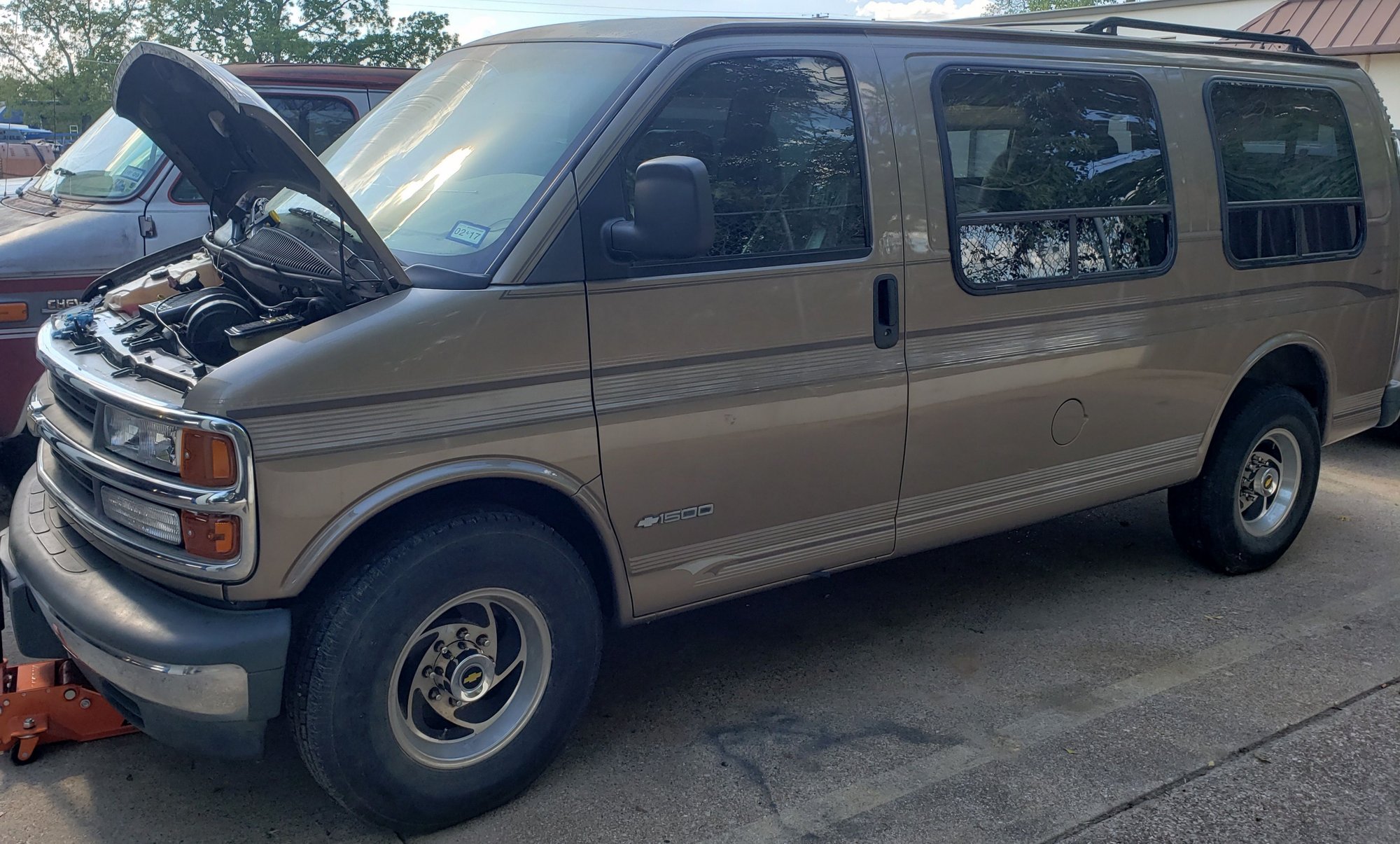

I expect it to be plenty lively when I start to lay out my cam options. I'm hoping to see some participation from all of the usual suspects.
Yes sir! My current cam in the 383 is a slightly quicker ramped, higher lift "Hotcam" with 1.7 rockers and a 108 LSA. It flies for what it is. Its not going to run any 13 second passes with a 3.73 gear but the torque is abundant through the whole rpm range and it cruises effortlessly. Comp was trying to suggest a 206/212 @ 0.050 with alot less lift and a 112 or even 114 LSA. I am glad I knew better. Keep in mind I have the Rhoads V-Max lifters and my cam is smaller than Comps suggestion at low rpm as it sits. The tiny cam they suggested would have resulted in 305 peanut cam like specs at low rpm and probably 240-250 psi cranking compression. The guy on the phone at Comp also thought I was crazy only wanting 2° of cam advance. This is what the 383 pulls with a 4L85E that has a custom built stock diameter converter that flashes 2,800 rpm and 3.73 gears with tires nearly 32" tall.
