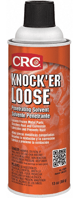

I have had great success with this.

There are 3 bolts on the face of the pulley and the one large one in the center. I had to pull all of them to get the crank pulley off, then you can put the socket on easily. ATF will work, MMO will work, CRC Knock'er Loose is good, you can even use all of them if you want. The point is to get fairly light viscosity oils with a bit of cleaning agent in the bores, whatever causes slip is going to be what you want.
