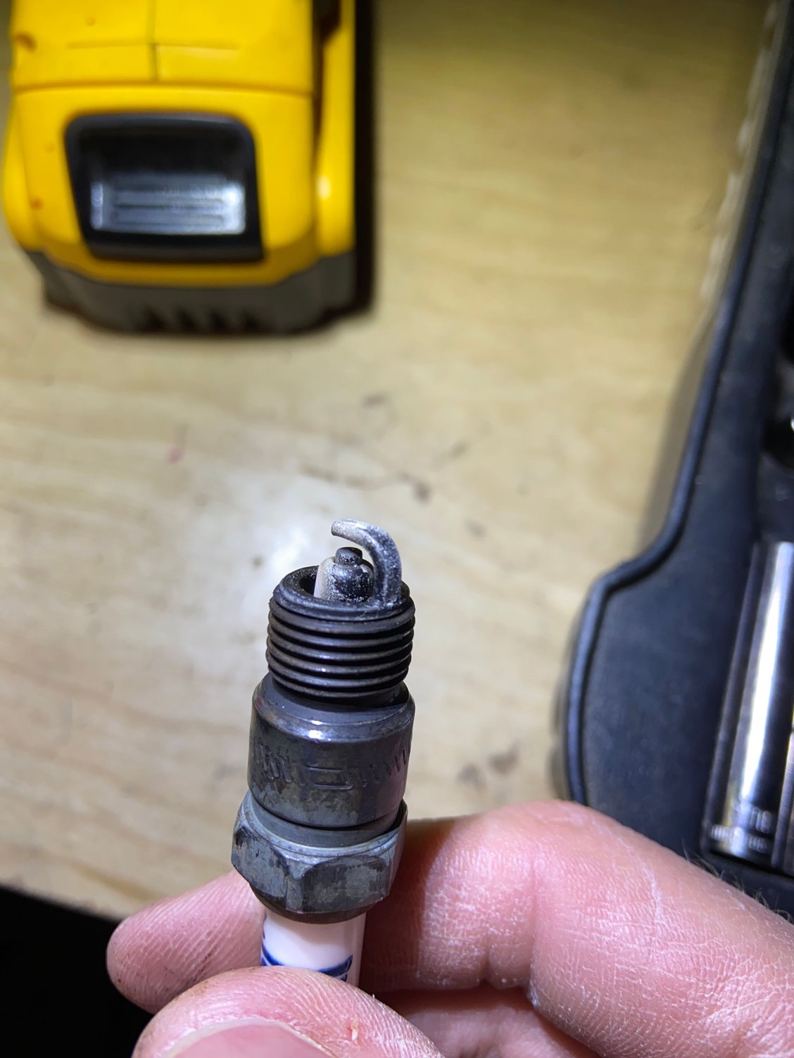

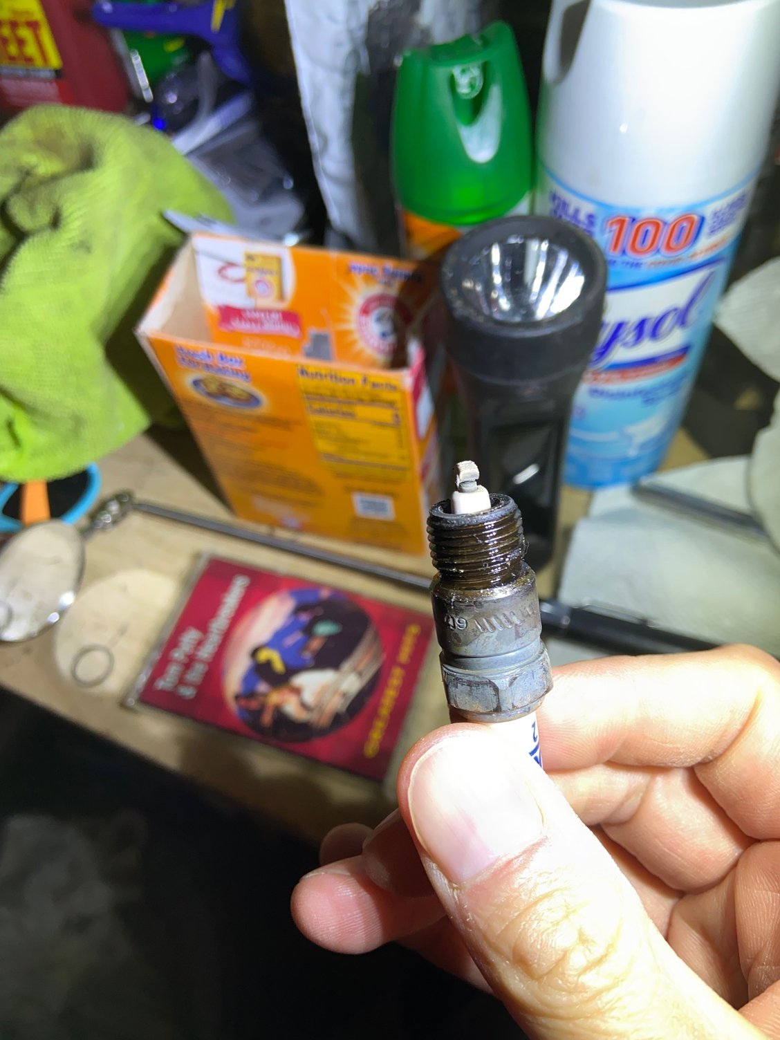

While checking and re-torquing my spark plugs a few thousand miles after getting new valve seals I noticed my number 1 plug looked different than the other 7 which all looked near perfect. It looks like I’m getting oil on the plug but only one area? The car is an 88’ GTA with 93k on a L98. I have no smoke on start up both cold and hot, no smoke while accelerating and deceleration and it doesn’t burn hardly any oil (less than a half quart in 3k miles). The car runs really good but oil on a plug can’t be good. I just want to know if maybe my new valve seal on number 1 is defective? Or maybe I have just one worn valve guide? Any input is appreciated.
These were a thousand miles ago:
I cleaned the plug up a bit and drove about 200-250 miles and this is what it looked like afterward:

Most of the time, what you are seeing indicates that an excessive amount of Engine Oil is being burnt in that Cylinder (Gasoline Burning Engines).
Valve guides? It doesn’t burn hardly any oil

What are they gapped at?
Also looks to me like they could use a little more timing, just from where im used to seeing the strap mark.

Timed at 8 BTDC and it’s at .45 gap as per AC Delco rapidfire instructions

Sounds pretty much in spec. Im just saying, if its happy at 8* no problem, but if youre like me and cant leave anything alone, id bump it up a little and see if it likes it.
But yea, looks like a little oil is burning in there from somewhere.

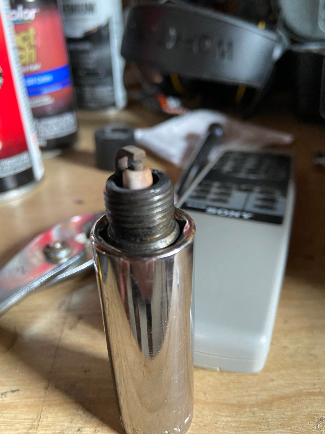

Here is number 3 plug and it looks good to my eyes:

My number 8 plug has looked like that for about 50k miles. I take it out and clean it when I get bored. Might be something with the rear cylinders?

Wait, this was your number one plug? I read your post wrong I guess. Maybe a different deal but I still wouldn't worry too much on it at this point. How old are those plugs? Center electrode looks rounded some.

Number 1 plug and 10k miles give or take, I threw on a new one a few weeks back.

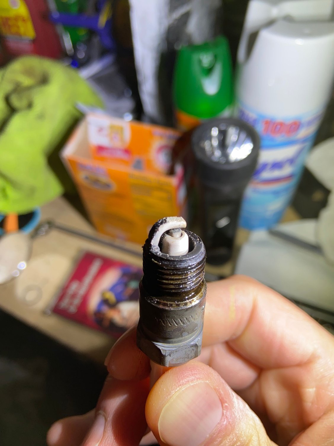

I really am leaning to that jacked up plug gap not being enough to burn off deposits and maybe a valve guide is leaking a little, after all this is a SBC lol.

Just wanted to update this thread, with the outstanding warm and dry fall weather in my area i I must’ve put on an additional 600 miles or more since I replaced and properly gapped that number 1 cylinder plug. I pulled the new plug and it looks good so far and I will chalk it up to either a bad plug or the too narrow of a gap that it had before.
Looks much better than the old one.
