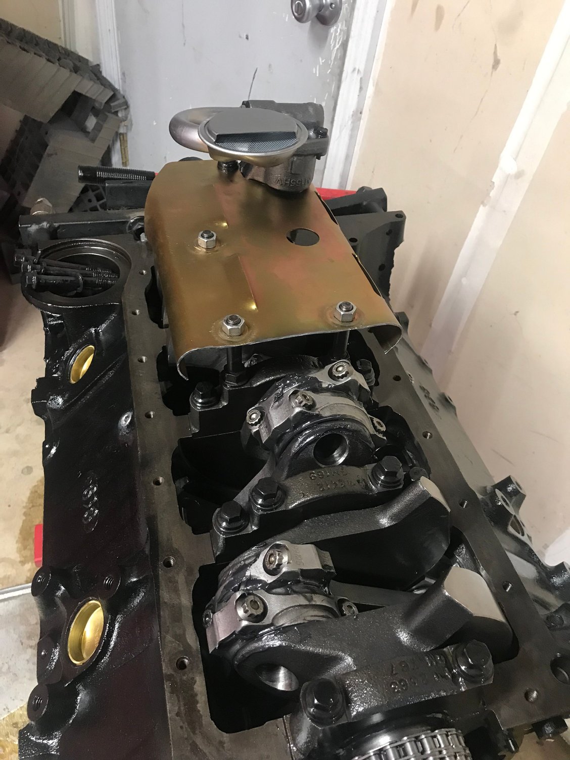

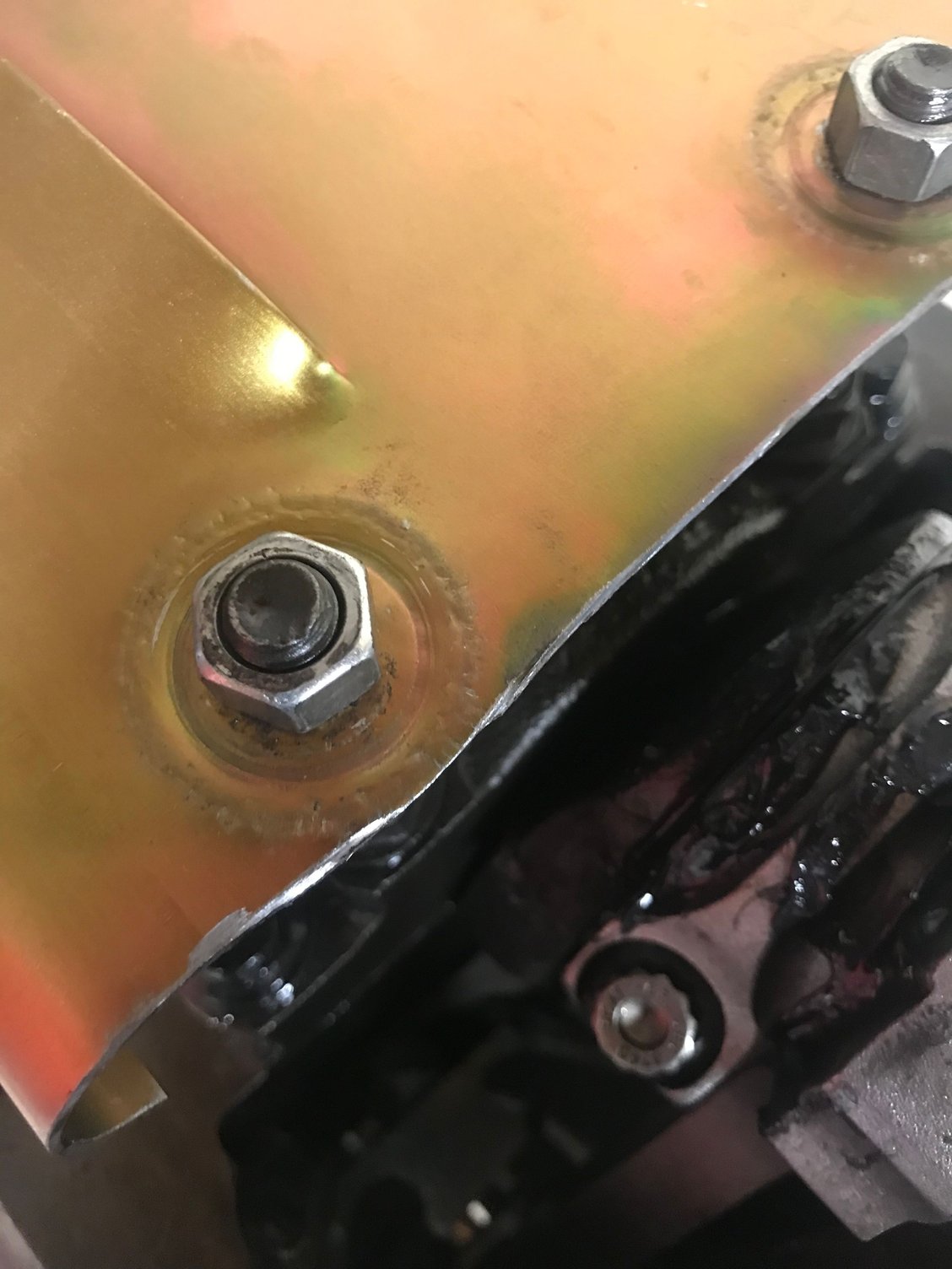

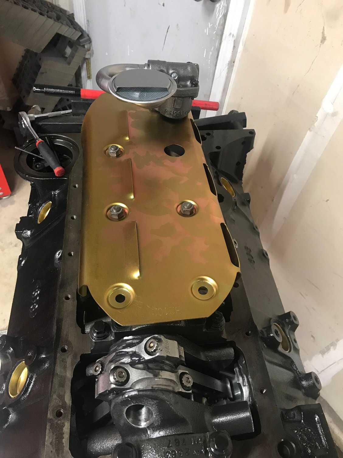

I got the milodon tray to work. Made some mods to it. Although I wonder if I should trim the sides of the tray like it was before cutting.
