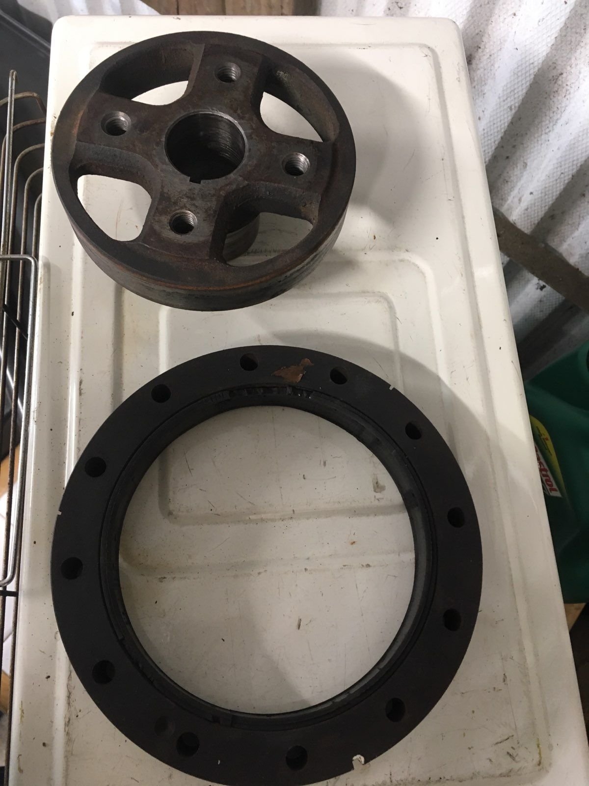

The timing won't be off unless you touched it (or your timing chain jumped, which isn't likely here). Yes the rubber can fail and allow the outer ring to slip (it's two parts held together by that rubber), so since you had to take it off for the seal just as well to have replaced it. And lastly, your fuel pump and your fuel gauge's sending unit live in the same general neighborhood, but other than sharing the same ground, are separate electrical circuits and your fuel pump can in no way "trick" your gauge out of a 1/4 tank of fuel.
Start with the basics, fuel pressure check, ignition system check (coil, cap, rotor, wires, plugs) and don't turn the distributor unless your 101% sure the "base timing" is off. It shouldn't be, but learning how to check (without adjusting, simply checking) such things will serve you well in fixing this .
PS, here's what happens when the two parts of the damper decide they ain't playin nice with each other anymore, now aren't ya happy you replaced yours ?.......
(Note, this is a six cylinder damper, but they all fail the same)

Thank you very much, this eases my mind a little that my sole daily driving car did no tear itself apart from the inside out. I will get the fuel pressure tester and maybe a compression tester as well and update after.
