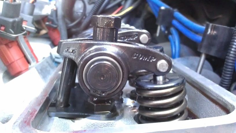

Originally Posted by EDGE
. I put a boroscope camera through the oil hole and saw the rocker touching the top of the cover. They were marked when they came off and I also took photos of where everything was. L/H side has the oil cap.
I guess being aluminium the strength has to come from some added bulk.
A quick look and it seems some of the bulk is in the height of the arm.
Check out the height and compare it to the COMP rockers below.
As that where the contact is on yours. Right above the roller?
These COMP rockers fit under my stock Vortec valve covers on my Vortec heads. The only trimming required was along the brace that forms the tube for the valve cover bolt to pass through. The shoulder of the rocker body at the trunnion boss made contact with that rail/brace,
As it is, the clearance is paper thin but there's no contact.
This doesn't solve your dilemma (although it was reported that the COMP's do fit) but it shows how fine the margins are.
That's exactly where my contact point was
Are you running a factory head setup? It must be the different valve stem length in my setup.
Not sure of my exact setup. The heads were bought from Scoggin-Dickey about tweny years ago. They came with the Scorpion rockers and I reused my original stock valve covers. Haven't experienced any fitment issues including when I replaced my valve cover gaskets.
