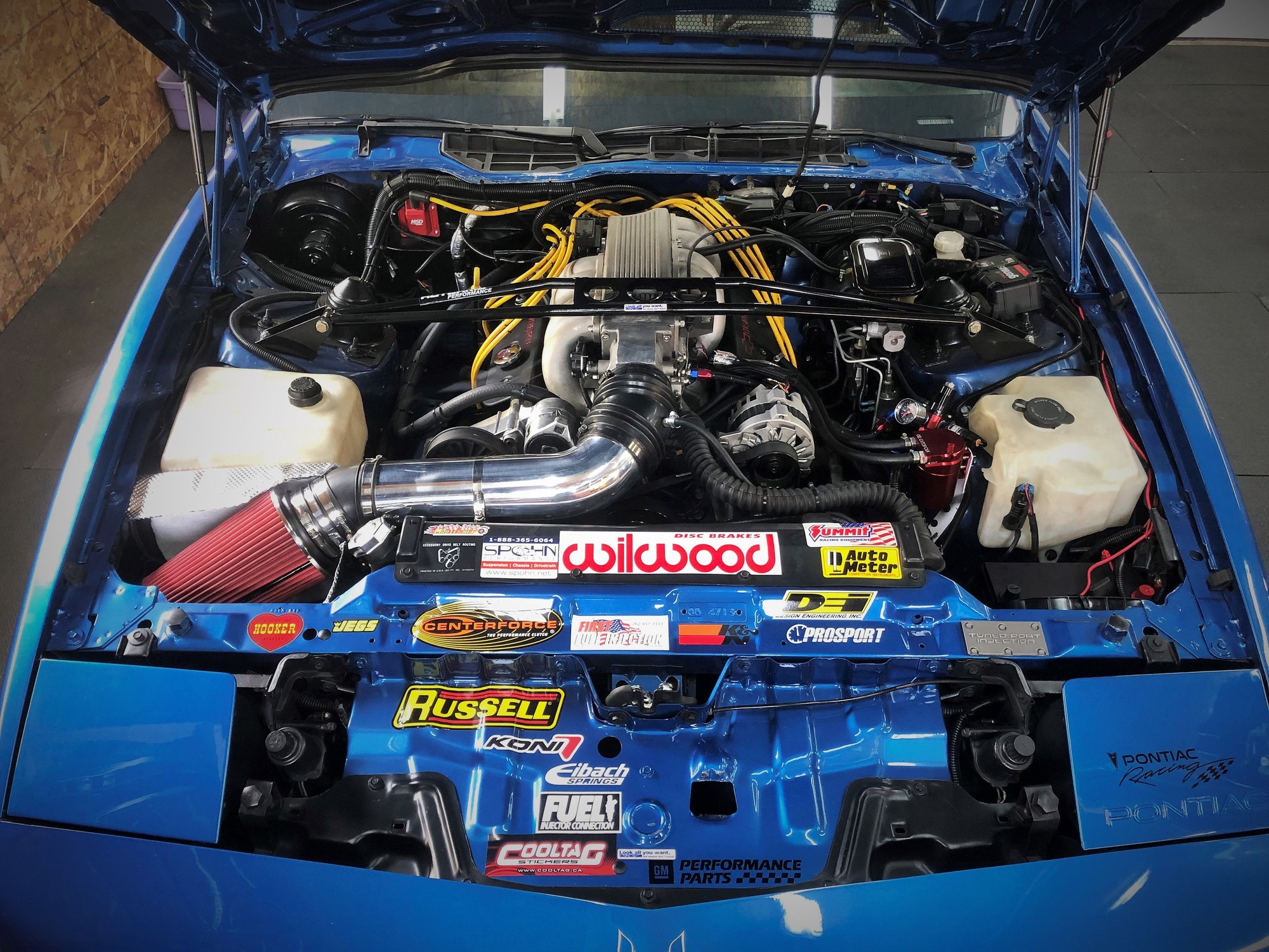

I ran my own test on a GMP SP383 Stroker with FIRST TPI intake (835cfm, 71mm, monoblade - year 2012). I had the SLP CAI. Anyone can run that simple test on their set-up, no need for dyno. The more vacuum at WOT the more HP is robbed.
Test was run at sea level with atmospheric pressure at 102.2kpa. 400HP engine.
The numbers are at 5900rpm
Baseline = With complete SLP Cold Air Intake with K&N filter = 96kpa = 1.83inHg vacuum = Delta of +1.1inHg
1 = With open throttle body = 99.7kpa = 0.73inHg vacuum
2 = With SLP Cold Air Intake tube only = 98.2kpa = 1.18inHg vacuum = Delta of +0.45inHg
3 = With SLP Cold Air Intake tube + box, no filter = 96.3kp = 1.74inHg vacuum = Delta of +1.01inHg
5 = Custom 4in Specter Air Intake with cone filter = 99.7kpa = 0.73inHg vacuum (maybe 3.5" would have been enough, but did not want to take a chance considering the price of these things!)
Like the above link article, the K&N filter was not a big contributor of air restriction (+0.09in/Hg). The airbox and air tube were responsible for 92% of restriction pre throttle body.
I don't know if 0.73inHg at WOT 5900RPM is within range, but it sounds acceptable. The vacuum is created post throttle body.
Now how does all this translate into HP? That's when you need the dyno. Probably not much at the wheel.
