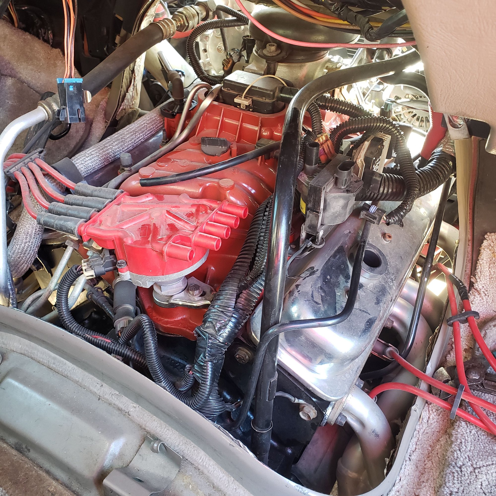

fast355
Late 90s vortech intake YES! I love it
What’s that in?
My 1997 Express 1-ton swapped conversion van. I did recently swap it back to the marine version of the same intake. I cannot tell that it did much if anything power wise though. Using the same MAF the frequency it is reading roughly the same all the up to nearly 6,000 rpm. I ported that stock base and the marine base. Both had a BBK TB matched to the plenum opening. I had a 48 lb/hr AUS spider in it that I swapped for the 41# Ford 6.2L injectors that are in it now used in the 2011-2014 Raptors as well as the heavy duty gas trucks. I am re-using that spider on another L31 that I just put together that I ported another base for use with aftermarket cast iron Vortecs. The base on the Express was ported out to match the ~210cc ports in the heads and that base would have had a bad mismatch on the other engine.
I had 3" duals on my Hemi Ram with a X-pipe. It sounded awesome up toward 7K. Sounded wicked with open cut outs too.
