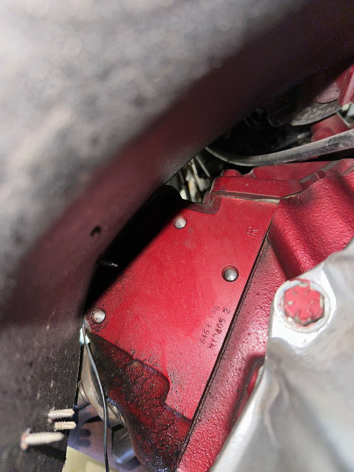

I have a Chevy 350 5.7L 880 in a Jeep CJ7 and cannot get my eyes or camera on the block numbers however I can see that it was made in Mexico and “1M0523 5ZZ4” is stamped where you would typically find the ID Code or VIN and “6463 188” and “MY0405 2” is stamped on the Driver’s side rear, facing backwards. See the attached photos for reference.
I am hoping someone can help me understand and identify this block.
Thanks in advance!

They’re visible once the valve cover is off. I’m thinking there aluminum heads and you have a gm zz4 crate engine. The head numbers will tell you what they came on.
I thought the zz3 & zz4 were not Mexican made but could be wrong.

They are definitely Mexican 880 blocks. GM shifted the production of the 350s all to Mexico because Mexico and South America was still getting them in trucks through about 2007.
Judging by the aluminum pocking out of the accessory holes and the ZZ4 stamp. My best guess is that is a legitimate ZZ4. The other number with that one is some form of serial number stamped into it.

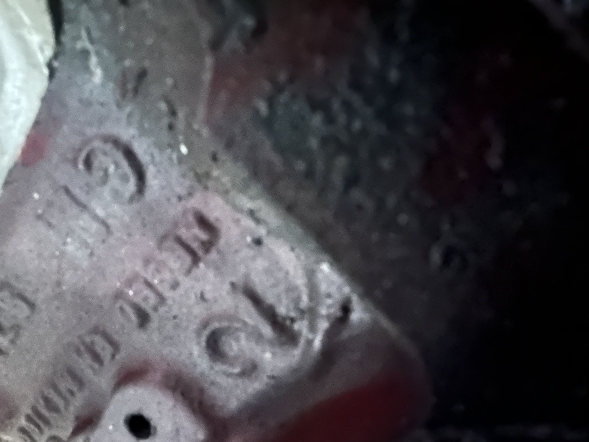

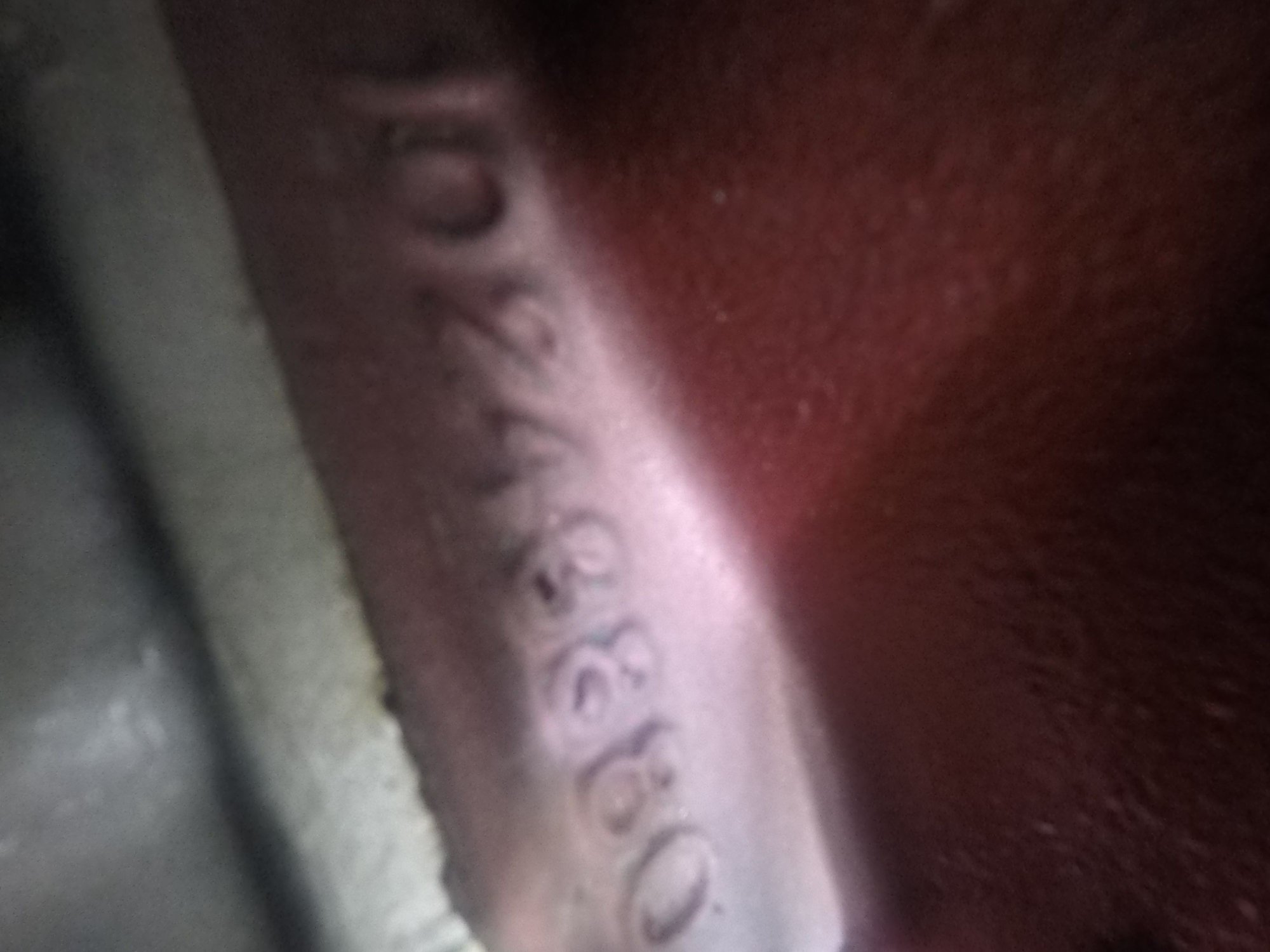

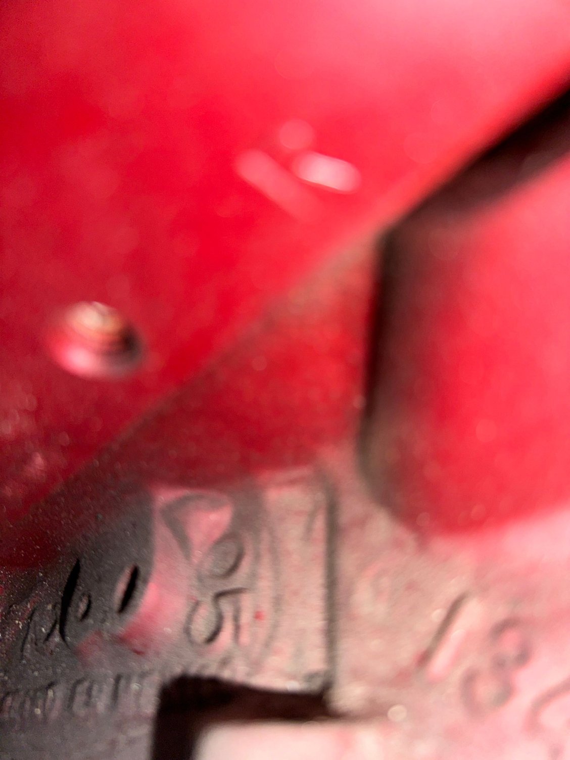

I was able to get some photos of the casting numbers by using my Go Pro camera mounted on a tripod. Looks like a 10243880 but I can't figure out the "2" and the "05" above "Hecho en Mexico" or the "I34" near the shift dial stamp. Thank you all in advance for your assistance.
See below and let me know your thoughts:

Looks like someone who has seen several ZZ4s reported that every ZZ4 he saw had ZZ4 stamped in the front on the suffix pad. Looks like all the ZZ engines from ZZ0 on had the numbers stamped.
How to verify it's a ZZ4? - CorvetteForum - Chevrolet Corvette Forum Discussion
How can I verify a ZZ4?? | Team Camaro Tech (camaros.net)
