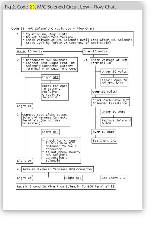

I have a code for it. It says code 23. Unless the code is for the MCS, and it’s cause it failed ?

It's probably a VIN G, but doesn't matter, it's the MCS on the carb'd car.
Old Oct 19, 2023 | 09:41 AM
Posts: 27,959
Likes: 2,469
Re: 1985 v8 5.0 305 carb IAT location?!

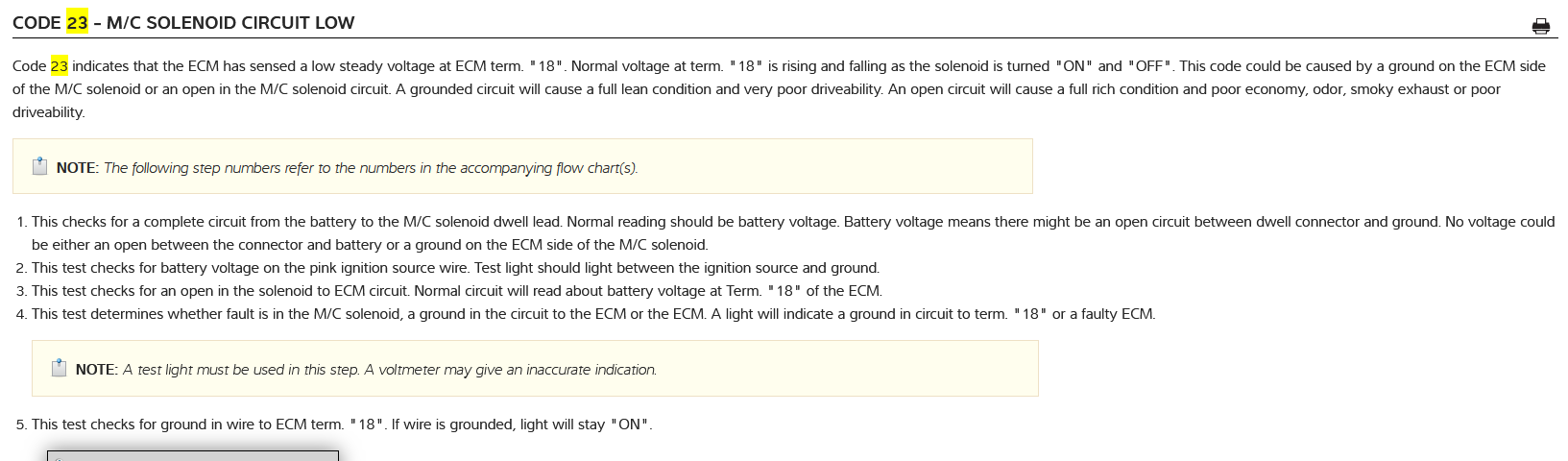

You said you had code 23 when you MCS was unplugged. Code 23 in a carb car means "MCS, the MCS is open or grounded, check all wiring and connections, adjust or replace MCS.". You "checked the connection", found it disconnected, and plugged the MCS back in; and told us it's now gone. Which of course was the exact right thing to do. You're now all done with code 23.
Those "codes" mean different things on different engines. After all, there's only just so many "codes" available, so lots of them they have multiple meanings, according to what system they're being applied to. Generally then, though each code may have multiple "meanings" and lead to multiple possibilities in the "troubleshooting charts", only ONE of them applies to any given engine.
In this case, since the meaning about MCS applies to your engine, the one about IAT does NOT.
You don't need an IAT because you don't have one.
