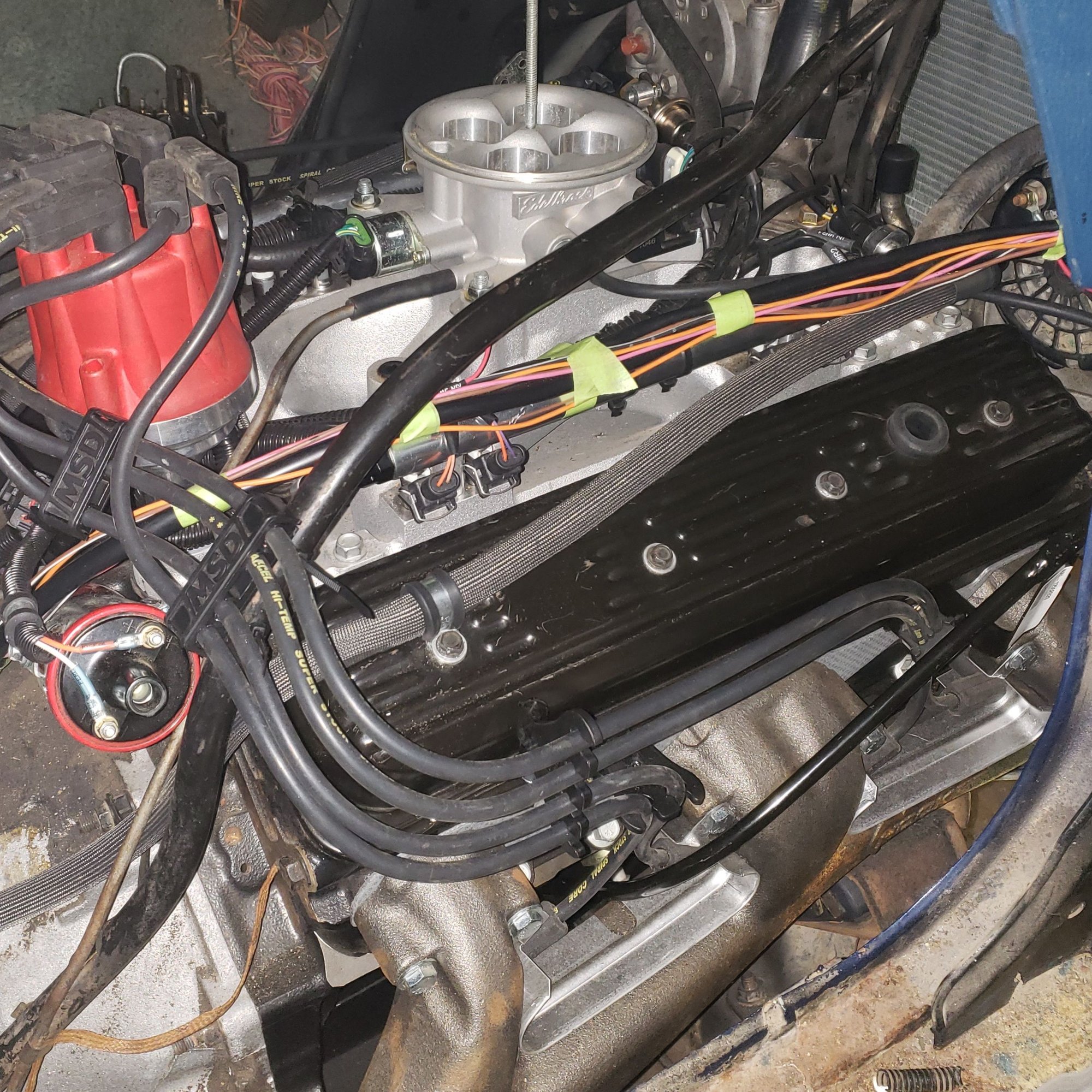

Okay... I ordered a set of Hedman 68478 mid/shortie headers, and I'm going to have to change my long straight-boot plug wires to 90-degree angle boot wires. What brand/part number of under-manifold wires do you guys suggest for an L98 with headers? I'd prefer gray or black wires.

https://www.summitracing.com/parts/a...+5ba0fb517989d
these work well on sbc with headers

I found the 87-95 C10 wire set works well with our cars with headers. Boots are a must. Accel boots are the best ive found.

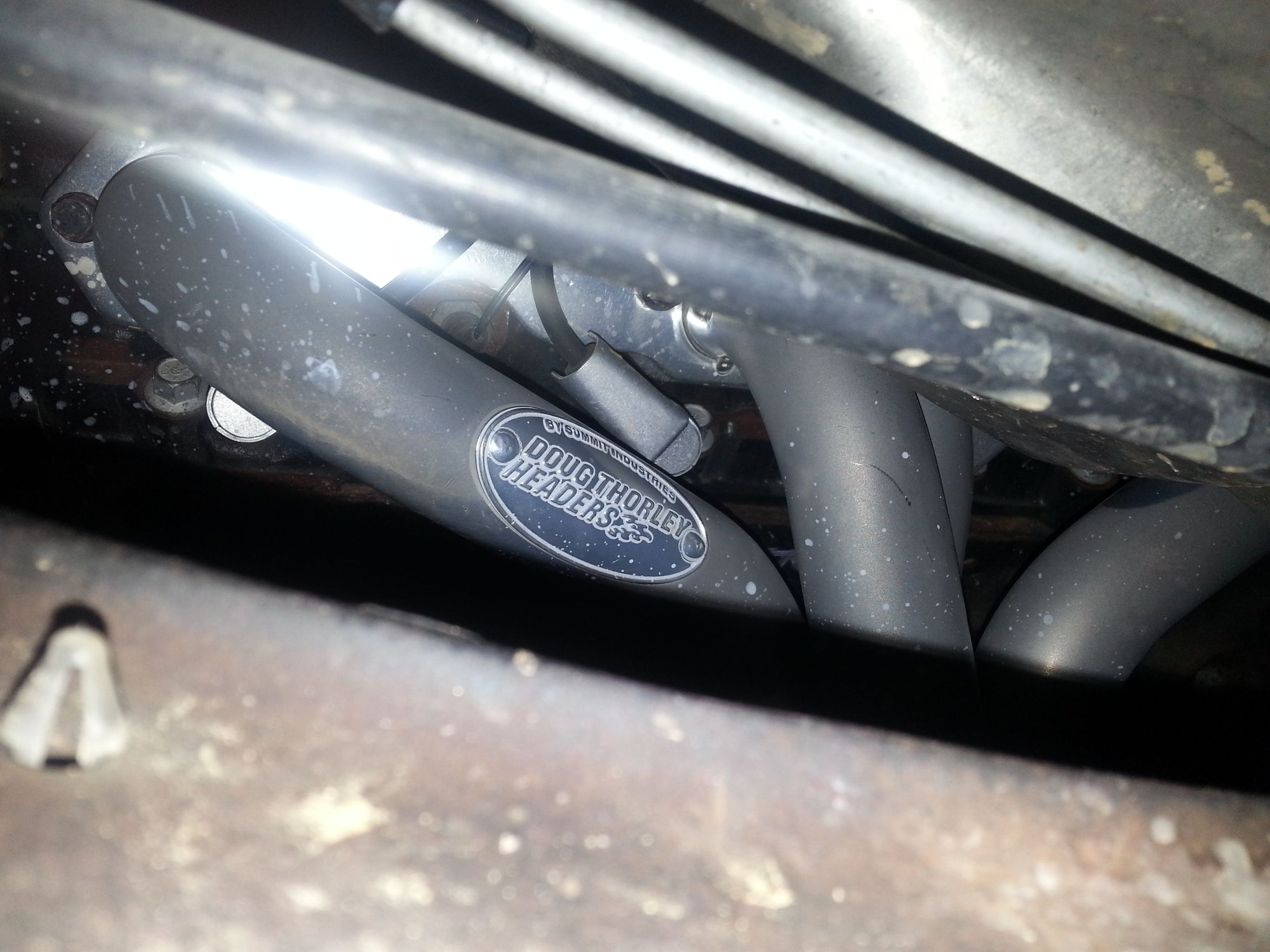

I think he means these. GM started using them on LT and LS stuff.

I am talking about the 90* aluminum stamped heat shields that went on a few cylinders of the LT1. Actually I recall these in use even before that on TBIs and maybe TPIs on #5 & #7. I know the 93 Fleetwood I had used them there. The heatshields clip to the spark plug hex and the boot, preventing the wires from flopping around as well.

Interesting i havent seen those but the round complete shrouded ones posted above by shifty
