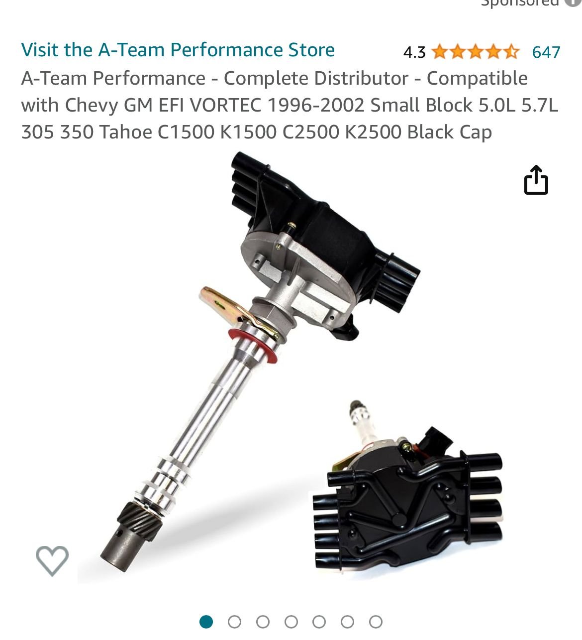

it’s tuneport with the newer model vortec distributor.

so not a 88-92 tpi hei with divorced coil it like the picture? Using a 411 ecm ?

that’s it there, has factory 1998 gm coil with the ignition module on it. It’s a 350 out of a 1998 Silverado, just has a 350 tuneport on top of it.

411 ecm ? Your being very vague on what you even have.

I apologize, don’t know the exact names for it. But if what you just sent was the 411 ecm then yes

sounds like a real cluster F, might find the ecm or pcm identity if then search for appropriate wiring diagrams to diagnose. Efi connection might be able to assist if you have all your information of what components are being used.
