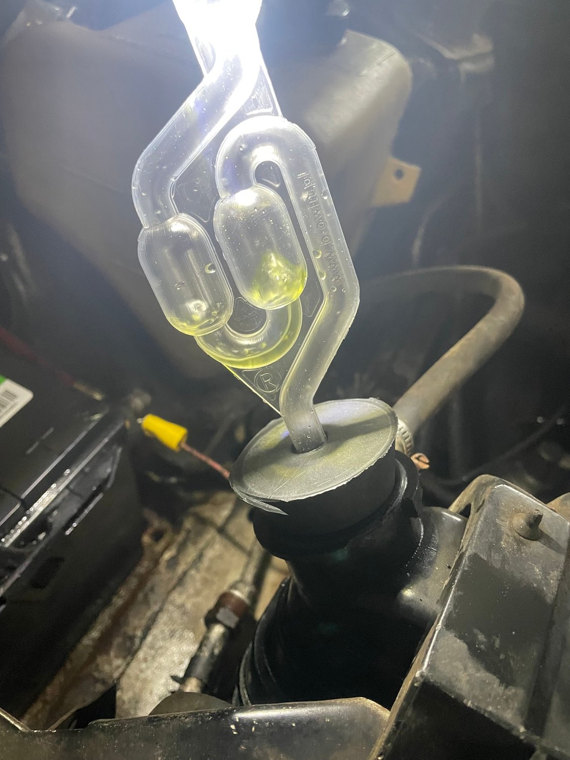

OK spoke too soon. I believe you were right LiquidBlue that the cap not being secure allowed any air to be pushed out the cap instead of into the overflow. After driving it more (with the cap secured) it was bubbling like crazy and the level was low when I did finally open it. Refilled it and still bubbling. Took Vinny’s advice and got a combustion gas tester from Amazon ($22, why not?) that will be here tomorrow. Wish me luck, I’ll report back when I get a chance to test it. Thank you all!!

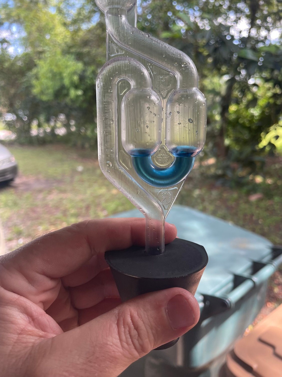

Not great news, I got the tester and set it up in the radiator. After running the engine for a few minutes the indicator fluid looked like it was starting to turn from blue to green when I shut off the engine. Coolant spit out of the radiator and through the tester so I couldn’t verify it changed color. Tried it again with the tester in the reservoir but there was not enough pressure to push the gases through the fluid until I shut off the engine when it bubbled through for a couple minutes. When it was done the fluid was for sure more greenish than the deeper blue color it was. I’ll test it again later tonight but it’s looking more like a bad head gasket or cracked head 🤬

Retested it and it definitely seems there is a problem. Took a before pic:
And now the after pic
So is there anything else that can allow exhaust gasses into the cooling system other than a bad head gasket or cracked head?
