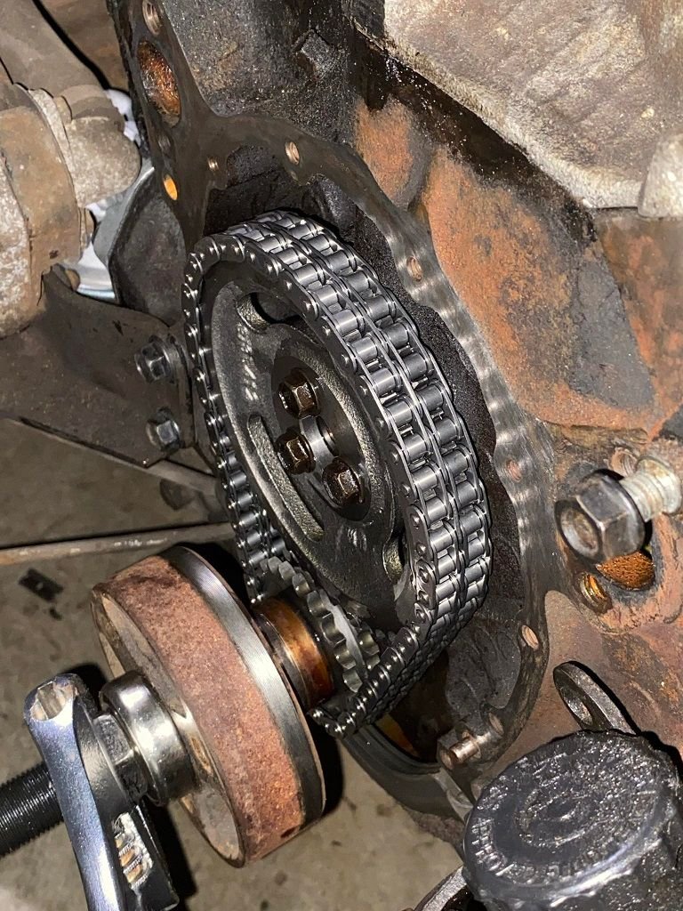

Not the best pic, but you can see I've got plenty of clearance at the timing cover bolt locations. The chain and sprockets of this set are definitely thicker than the stock setup and aren't in the same plan as the case thrust surface, so they do sit closer to the oil galley. But as you said, the sprocket can't get any closer. Just a little paranoid about the .030".
The set is a Cloyes 9-1100. Zero slack upon installation. So much better than what we took off.

Yeah your block doesn't have the bolt hole boss issue; but some do. Their bosses are real wide and protrude too far into the volume where the (wider) chain needs to be. Yours looks completely normal and OK.
As a potential useful FYI, I always drill the 2 plugs to the sides that terminate the lifter feed passages, with about a #70 or so drill bit; to squirt oil on the chain. (on the sprocket actually but it gets slung out to the chain)
That chain won't make any extraneous noise, fortunately. It's a decent setup.
