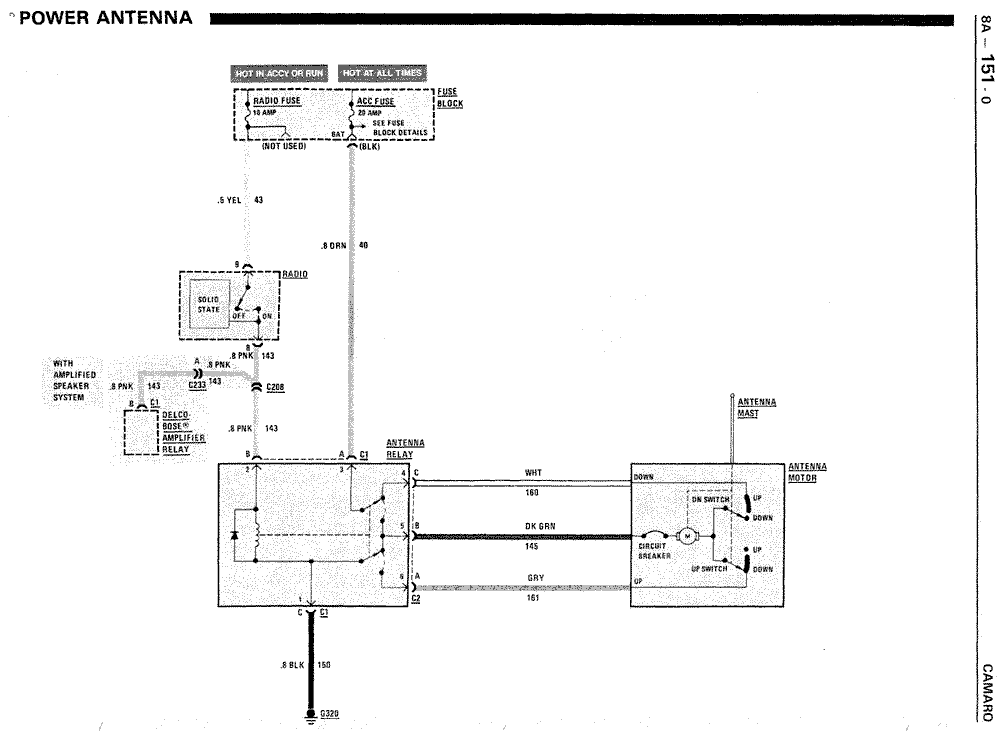

Hi kwahamot, The most likely suspect, based on your description of where the sound originates, is the power antenna (if your car has one). My next move would be to unplug the accessories fuse.
In this diagram I found, it appears the power antenna circuit gets it's constant power feed from the accessories fuse, so if you do have a power antenna, pull that fuse and see if the noise stops

I think it’s the power antenna.
What relay would fail to allow direct current to that?

It's not usually the relay itself that fails, it's the two switches shown in the diagram in post #10 labeled "Up Down" that are not being properly activated within the power antenna motor unit . You can unplug the relay to stop the antenna motor from continuously running so that you can put the accessories fuse back and have all the other things it provides power to still work (interior lights & so on). If you do a search here you'll find that a certain model of Jeep antenna is a very close match for your failed unit, or perhaps there are places that will rebuild it, I think I recall reading somewhere of a place that rebuilds them (finding a new one is a needle in a haystack proposition, it's been discontinued for quite some time now) . To unplug the relay you will go under the passenger's side dashboard by removing the plastic covers under there, and find the relay with orange, pink, black, white, grey and dark green wires going to it, unplug that and the antenna motor will stop running continuously, then the antenna unit itself will need to be removed and repaired or replaced.
I pulled that fuse (third row, third column, 20 amps) and the noise stopped! Yay!

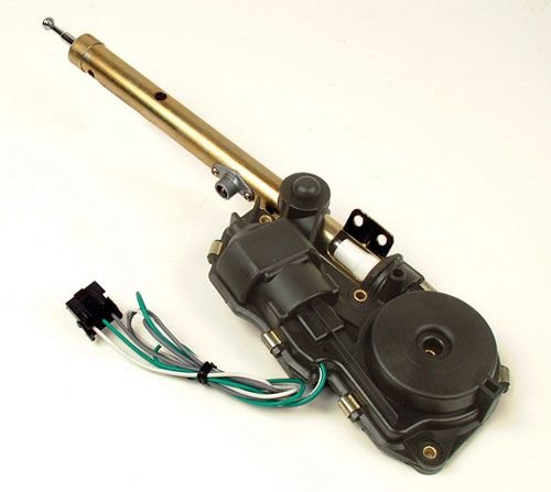

Begin the process of removing the power antenna. The plastic inner fender liner has to come out, there will be both a 3 wire wiring connection and the antenna coax connection that feeds the radio signal that'll need to be disconnected, as well as a mounting support bracket along with, of course, the threaded piece you can see at the top of the fender. The antenna coax can be disconnected at the antenna itself, but the three wire connector (that runs the motor), has no disconnect at the antenna, it's wires run through a rubber pass through that's behind the passenger side kick panel and plugs right into the relay. If you want to be able to use the car before you tackle the whole antenna replacement job, you can unplug that connector at the relay and put the fuse back in so that the other stuff on that fuse will still work. Once you get the antenna unit out, the real work of either getting it repaired, or finding a suitable replacement will begin.
Full disclosure; on my car, when it failed (as they ALL always do) I replaced it with a non powered antenna and that was that. Your car sounds much too nice for not trying to get the power antenna working one way or another....
You'll need to unplug the black connector here;
And once you've removed the failed antenna unit, it'll look like this;
(note the screw in connection on the gold colored mast section for the coax, and the black plug at the end of the wires)
