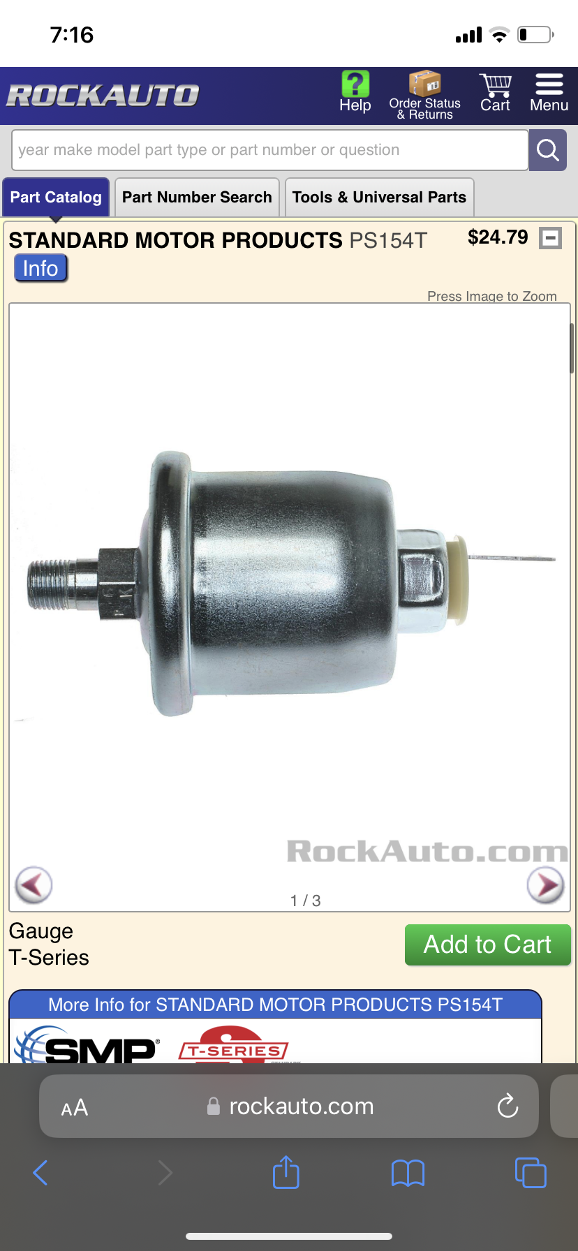

Yes I’m changing the one with the single wire that is the one that was cracked that one goes to the gauge correct? Hopefully that was the cause of my oil pressure dropping.
Is this the one I need? There is multiple ones but it does not say dimensions.

Is the gauge 60, or 80psi?...

It’s A 60 psi. Also how could I check the gauge inside? I also have a feeling the gauge might not be working right. I think the previous owner might have switched the the gauges because the temp gauge does not work or the gas one.

PS154. I just replaced mine a week ago...

Awesome so the one with no T thank you.

Someone can correct me if I'm wrong, but I think the "T" version is just a less expensive version (which could also be less reliable)...

I’m going to go with the ps154. The one with the T looks a little bigger it could be I’m just seeing things. I think they carry the ps154 at oreily’s I’m going to check tomorrow.
Standard Motor Products "T" series is their cheaper, value line of parts.
