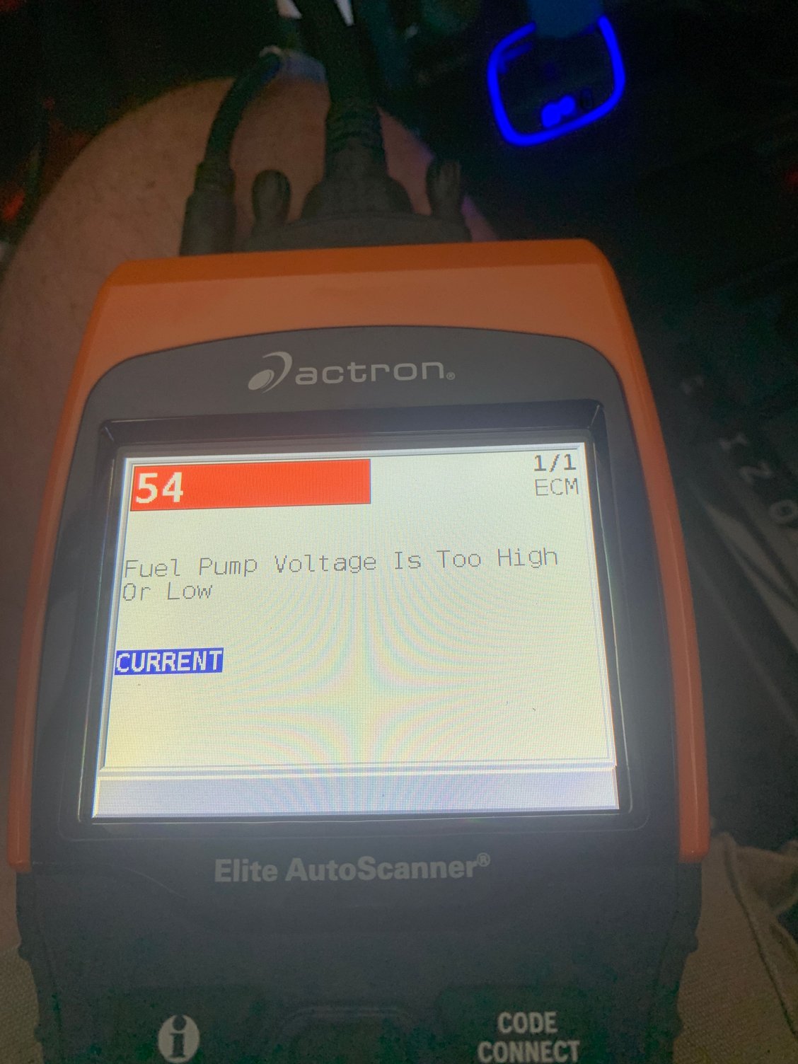

I wish the OP had answered you, so I'd like to hijack this dead thread if that's ok. I'm now chasing a similar problem with my 86 T/A 305 TPI car.
I'll state why I'm in the FPOP area after the following history recap.
I've restored a lot of things on this old engine including: rebuilt HEI distributor, pulling computers, exhaust manifold leak;shaved, intake manifold-upper/lower, fuel injection rebuild, water pump, timing chain and gears, dropping oil pan and starter to do that, , half a dozen sensors and/rotten connectors that crumbled in my fingers from age while testing them, ignition starter switch, power brake booster, and reading an 8 inch thick service manual. Not in that order of course and many other restoration items, cleaning up things as I go.
Now it runs great, starts better than it has since I bought it in 1990. Many trouble free years till about 5 years ago, and it just got old.
One day I filled it up for a nice test drive, and it stalled on deceleration; slow down to idle, stalled. Went around a corner, slowed down, stalled; hairy.
I fixed that I believed with the IAC connector and one valve. Brake booster got RR-d in there too. Lot's of trouble tree shooting, but it is intermittent now and section B:intermittents don't really apply except for the engine grounds, which seem fine. Anyway, it was fine.
Then another stall problem arose (or the same one I don't know for sure; just more chronic). Stalls in the driveway idling, revving, any rpm really.
I went back through the Distributor and double checked the ICM, pick-up coil, even found the four wire harness connector (don't ask how I found that). All fine. I eventually got it centered after re-stabbing so many times that now I can time it without hitting the plenum : ) Got good at that, turned the oil pump till she lined up. Went through and replaced dodgy relays with high contact resistance and was careful to get correct ones for FP, MAF sensor and MAF burn-off. MAF is new, as I buggered the screen on the old one which was still fine. (Unhook the MAF connector, and it still stalls.)
Timing is dead-on at 6 degrees btdc. Runs fine, lots of power, revs fine; even power brakes; no shudders. Ready to drive. Stalls at random. 10 seconds, 5 minutes, 20-30, no pattern. (Now I have to fix a radiator heater hose bib that I must have leaned on, cuz it leaks when approaching fan-on temp, so trouble-shooting time is limited for now. Sigh.
I've watched the computer lines for ICM reference signal and ohmed out the four-wire many times. It runs without the 4 wire, which tells me it's not the pick-up coil, as the computer takes over without the ref signal when you do that. Checked engine grounds with DVM continuity and voltage drop testing. Less than or equal to 0.1 ohms and less 0.1 voltage drops, as far as meter allows for accuracy.
Back to the Fuel Pump Oil Pressure circuit. This seems to be the only other thing than the crank ref signal from dist, that would tell the computer to just shut off the engine like you turned off the key. The thing is, it works. I cleaned the contacts on FP relay for fun, and it ran for 30 minutes; another false positive.
The next day it stalled again. Did I mention it's usually a hot day when things seem to work. Seems like it, but I've been fooled by this intermittent over and over now.
Last night I pulled the FP relay out completely to see if it would start. It didn't. Cranked far past the oil pressure threshold. So it MUST be the switch right?
Came back ten minutes later and it started right up! And it ran till I had to shut it off!
The FP relay should run the car, reading between the lines of a million half-*** descriptions in the Service Manual, and pulling it out would put the load solely on the switch, until maybe the switch sends a signal to the computer that there is not enough oil pressure, of which it has plenty according to the gauge. The 86 has a gauge pressure sender, AND an OPS both.
I am about to change the OPS just because. Maybe THAT is the intermittent in this whole scenario. I'm familiar with the Senior Member's advice on here, been reading and learning this car for 5 years now and value their insight. Oh, my "scanner" is kinda useless, and can't afford another as I wasted money on an Ac***n which talks to ECM about 5% of the time, but the only codes I could ever get was a 42 when it died, and before shutting key off and paper clipping the aldl.
Ask me some questions please, as I have done a lot more testing with the tools I do have. I am an old electronics tech with a limited attention span now, so it's hard to follow the relay logic in the schematics; are relay contacts shown activated, or in engine-off state for example. Circuit descriptions in the 86 manual are not comprehensive to say the least.
If you think I should start a new thread, I am going to try to do that next. Thanks, John

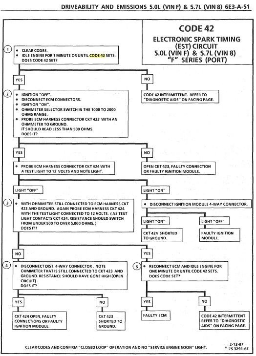

Code 42 seems to be a short or open on the EST circuit as identified here in this 1988 service manual..

I've replaced both relay and recently the switch, thanks. It's been awhile since I did fuel pressure test when it stalled, but if I remember it was good pressure right up to the stall, then only a glitch in pressure, but no real drop in pressure, and no engine stumble at all. Just like turning off the ignition.
Thanks again on the charts, pretty much the same as mine, and 42 hasn't come up since I dressed the plug wires. I have a spare ICM (cheap closeout) and may replace it with some super lube thermal paste. (Not the suspiciously dielectric looking grease that Echlin gave me.) I'm still not convinced that stuff didn't wreck the new ICM in there now. When I rebuilt the dist I used some thermal paste from a computer store on the original 39 year Delco icm. Both parts have been tested, but not warm, so they may switch, but not under load at speed.
I've run through that chart, and it seemed correct, but remember this thing is a random intermittent; I've thought I'd found the culprit 50 times, only to find out it wasn't. I've ohmed out ckts 423/424 watched a solid ref pulse on 430 and voltage drop test on the ground (dist body).
I was thinking along the lines of your fuel pump relay fix and that's why I replaced the switch just hoping that same thing as the relay seemed flakey on the unused contact which made me not trust the whole relay. No dice though. Thanks
I just finished some voltage drop tests from bat + to engine grounds, generator grounding, and grounds at the ECM inputs. All less than .1 volt drop.

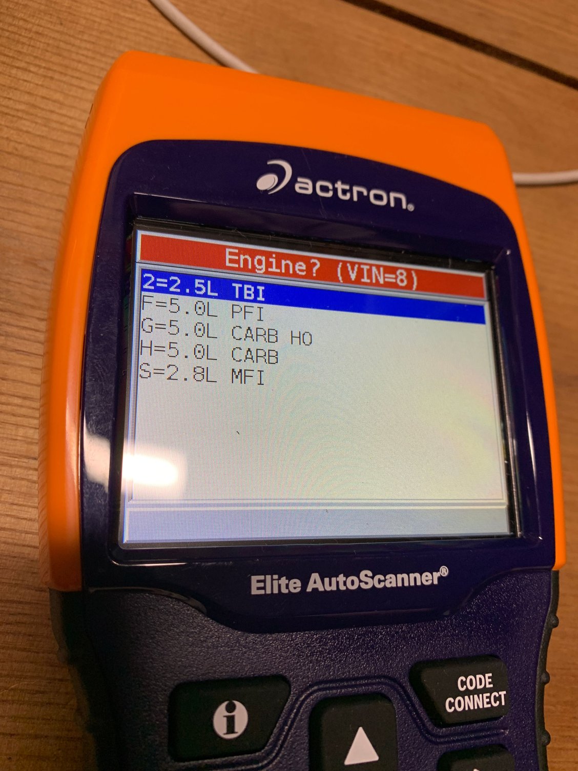

I can't get my 9690 to communicate with my 86 1227165 ECM more that 1% of the time. Occasionally I can get a code dump (no codes stored) or a datastream.
How did you get yours to talk?
I even ordered a Moates and an ALDLDroid app on a chromebook, picked the most likely .adx file, and it still won't talk.

On my CP9690 for manual engine selection for Pre 1995 in the 1986 Pontiac year, your 305 TPI is available as a 5.0L PFI selection. Is that how your CP9690 unit is configured?

Yes, mine is configured as the F-body 5.0 PFI (ported fuel injection)
Then it goes to the "connect the cables and cycle the key/off key/on" message and keeps saying "Link Error, cycle the key" message forever.
It just never syncs up. Well, almost never. But I can do it all day, and it won't ever receive data.

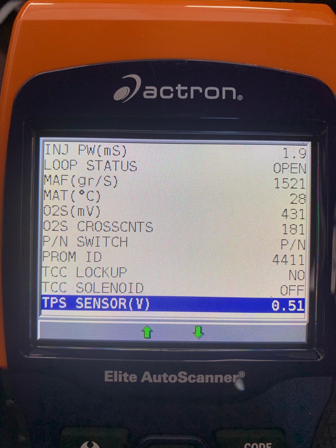

According to the scan tool my prom chip is a 4411 but the ALDL software describes the ECM type as a 1227747.
Have you cleaned the ALDL connector socket to make sure the contacts are clean and conducting well. They get dirty over the years.
Getting back to your stalling issue, have you ruled out a bad ignition switch?
