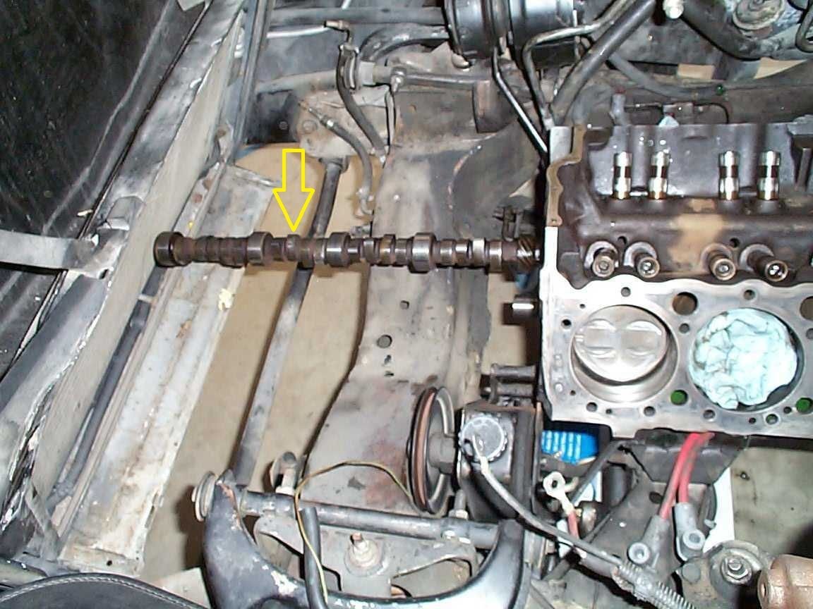

Been there. Along with a bumpier stick,
Some of the aftermarket options could be better for a 350. There are limits to what can be pulled through the runners, even with port relief. This is about as far as I dared to go:

Lost a lobe there, huh?

As I recall. the lobe was still there, or at least all the material needed for a lobe was in the oil filter. Pennzoil.
