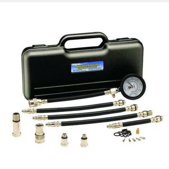

I agree that the exhaust system can cause that noise when it's restricted. There is a SUPER easy test for this: Got a compression tester with thread-in hoses for the various spark plug hole sizes? Get or borrow one.
The larger hose (second from the back, in the pic) will thread right into your O2 bung. Thread the Schrader valve out of it, stuff some rubber hose over the coupler end long enough to get into the car or up to the w/s, stick a pressure gauge on the end of the hose (something with more than 10 PSI resolution, less than 100 or so) and replace your O2 sensor with your quickly rigged exhaust pressure test hose.
Exhaust back pressure should be about 3 PSI or less, under max engine output, so go for a quick test drive. Go WOT to red line, if you build significantly more than 3 PSI, you found your "hissing sound". The last time that I DID THIS TEST on a car, I had 22 PSI, just flooring it in neutral. Problem proven.

You ever test the pressure? Love to know what you were building?
