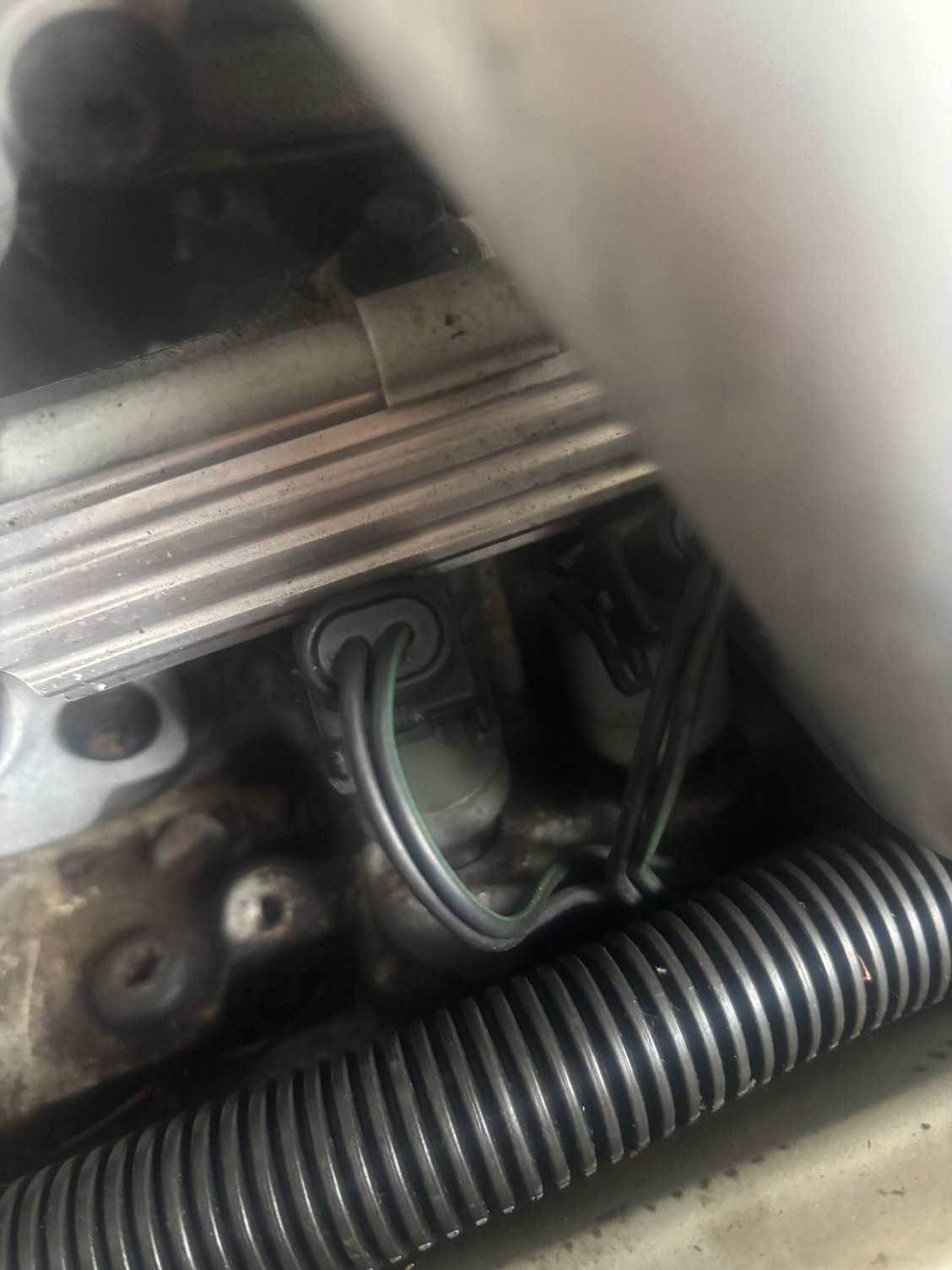

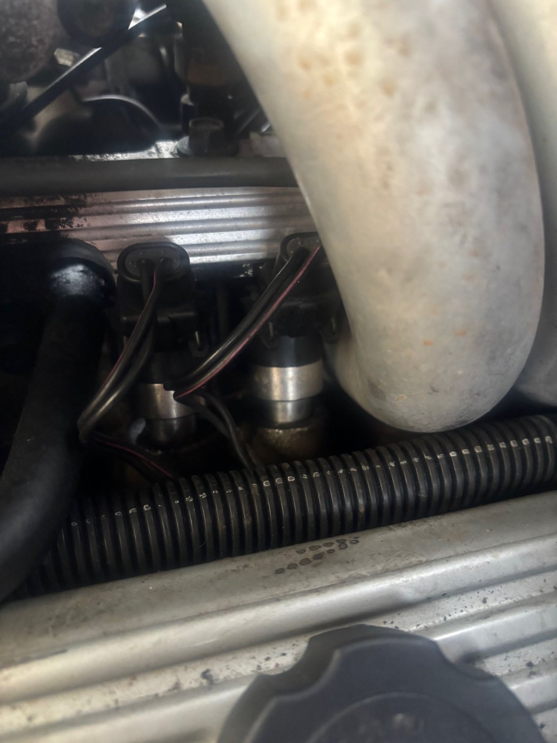

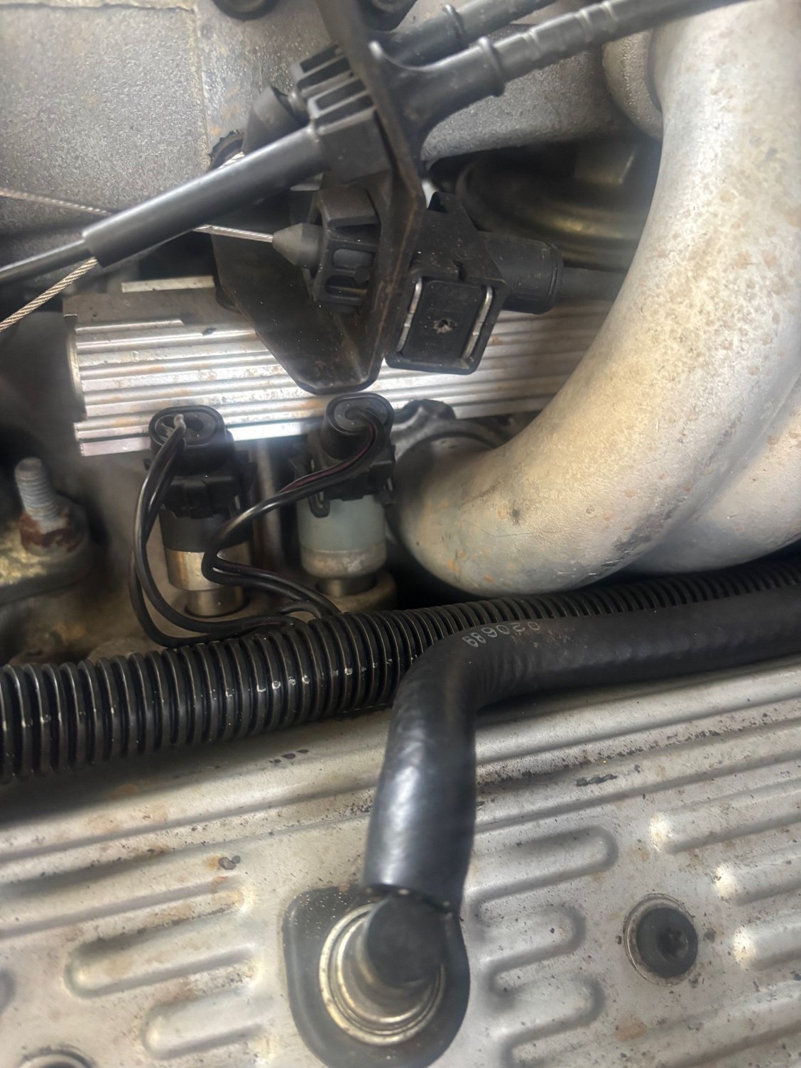

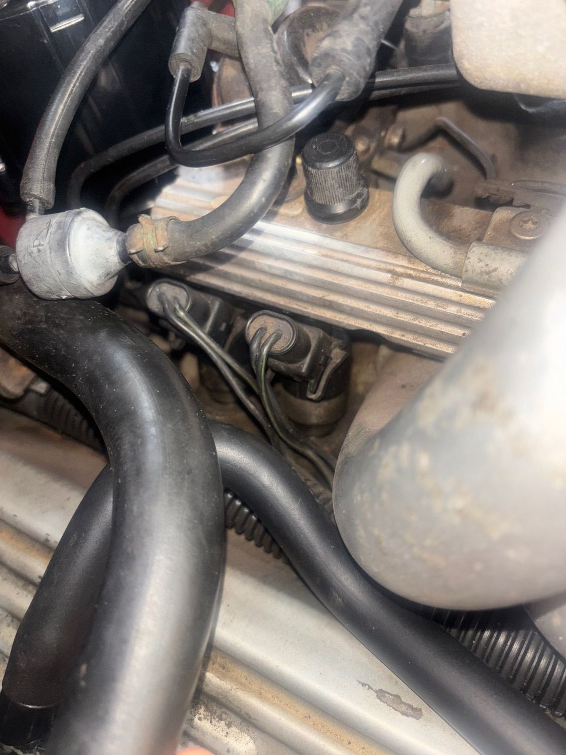

By the way, here are the pictures of the injectors. It looks like they are a mix. 3 out of 8 are that greenish/grey type you described.

looks like a multec from tpi and a lt1 injector. Definitely not a matched set

Yes you car has a mismash of original RP Multecs and later replacement injectors. This was typical of how things got done back in the day before people knew better. They tested all of them and only replaced the ones that tested bad. In hindsight it was a bad idea because all 1989 to 1992 RP Multec injectors are defective they just might not have tested that way at the time. They are little hand grenades with the pins pulled so far out it's just about to let go and it will let go sooner or later.
Now you just identify them as being 1989 to 1992 RP Multecs and throw them in the trash. No testing needed. Replace with a matched set of 8 Delphi injectors.
