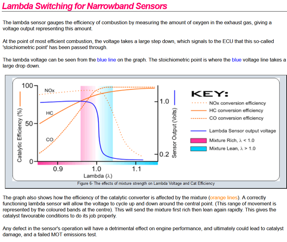

I recommend learn how oxygen narrowband sensors work, if you wish to become a technician of the engine and ECU, engine management.
Narrowband sensors are basically useless for performance, I never use them. We only use wideband for performance applications.
https://forum.hptuners.com/showthrea...l=1#post677442
However narrowband can still be useful diagnostic tools, it is worth learning how it works. Engine need to run 14.7 to 16.5:1 air fuel ratio to avoid fouling the spark plugs for idle and cruise conditions. For example I always keep 15.2 to 15.8:1 air fuel ratio using wideband sensor, is keeping plugs to last the longest, cleanest plug possible.
The narrowband can only sense 14.7:1 average air fuel across some bank of cylinders. What they call stoichiometric mass to mass air and fuel ratio is purely theoretical, nothing ever can combust using perfectly matched mass ratios using a single sensor because all cylinders are averaged together on that bank and every cylinder is off slightly from perfect. And even if you had one per cylinder the reported ratio is temperature dependent, higher temperatures will report richer air fuel ratios in general. At some high temperature T the wideband will fail altogether and simply report rich no matter what, they are often installed at some minimum distance from the turbine or engine, unlike narrowbands which tend to be very close to the engine and partially rely on engine exhaust heating to perform faster or better. They often won't work well when cold and you should be aware of any cold-temperature situations such as sitting at a stoplight or idling in neutral after a cold start, the narrowband will not function properly. It may take 15minutes to warm well enough or not even warm up enough at all until you drive it around to put some heat into the narrowband sensors.
If you can understand narrowband and wideband output, it will help you diagnose all engines, they only need 3 things spark fuel air and the wideband/narrowband looks at 2 of those. You can usually look at a wideband gauge and know immediately if there is some issue with fuel combustion quality, it is a handy gauge to have on an engine.
Narrowband switching action is meant to be digital in nature. Either *ON* or *OFF*. 0 or 1 volt, 995mV to .005Volts for example is a typical range. It can of course .028v and .112v or similar, doesn't need to be zero exact, that is the point of digital anything even close to zero assumes a zero by the ECU
