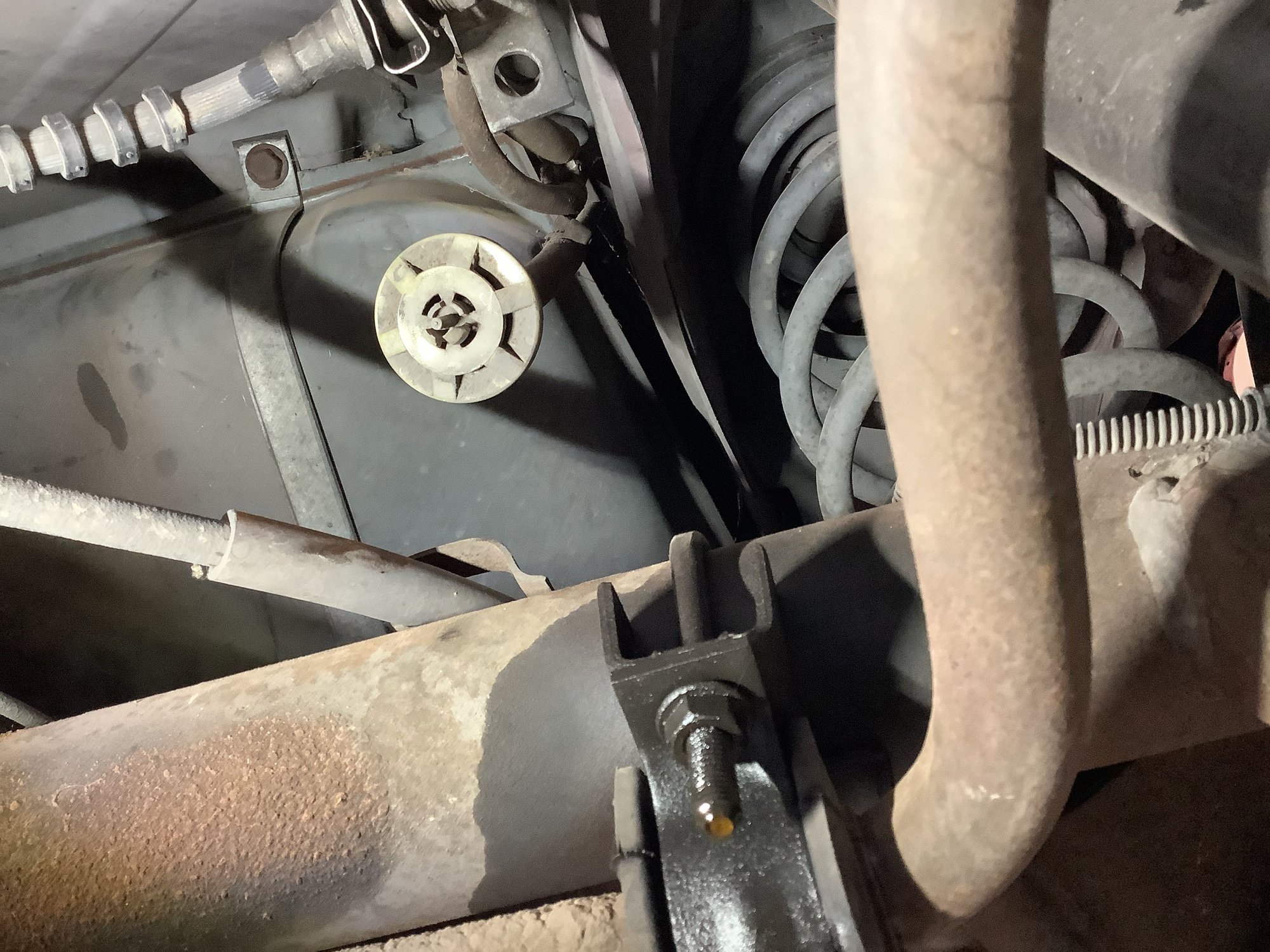

BTW - did you check your pressure relief valve located near the bottom of the gas tank. they are notorious for cracking. good idea on the battery.

Would this be said valve? How do I check it? Thanks!

yes, that is the valve. do a visual inspection and look for cracks. you can also take it off (but risk breaking it) and probably put finger on one end and blow on other or something like that. I think is sort of a check valve, if enought pressure builds in tank it will open. often people will smell gas in its area. they have exact duplicates at Hawks if you just want to replace it.
looks like your gas tank may have been off at some point in its life
What makes you say that?
THE FUEL TANK VENT VALVE has nothing to do with my 20PSI fuel pressure, correct?
Thanks.
Thanks.
missing leather straps. all I know is it probably keeps the tank pressurized to some degree.
bETWEEN THE METAL STRAPS AND TANK? Good catch, I will make some.
yes, I dont know if it is rubber or leather, haven't been down there in a while. too busy building my new garage to play with my toys lately.
