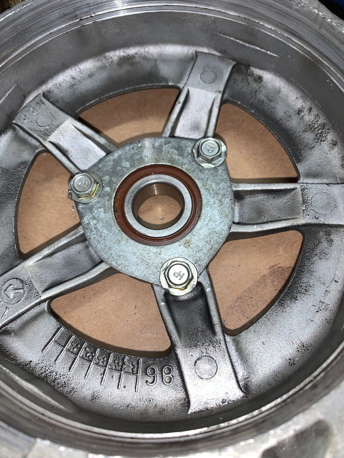

Late this summer I had the alternator in my 1986 Firebird stop charging, so I ordered and installed a rebuilt ACDelco alternator from RockAuto. When I installed this rebuilt alternator it sounded as though there was a toothed belt driving a blower under the hood. I wanted to keep the car as close to original as I could so i ordered a rebuild kit for the old alternator and installed the kit. Problem solved.
80-90% of the belt load on the alternator is on the pulley bearing so it is quite likely that is where your issue might be.
Notice the flanges on heads of the three machine screws for the bearing keeper are bent over after bearing replacement ,to keep the machine screws from working loose.
