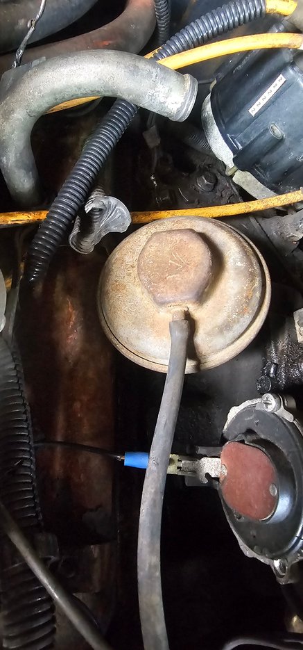

Got a 83 pontiac firebird with a carb 305 got new valve cover which are taller and what i assume is the egr valve is in the way anyone know where I can get a block off plate or do I gotta try and make one

Why not make one ?

dont really have the ability at home right now id have to make it at work and hope its right when i get home it be easier to just buy one
https://www.trucktok.com/products/tr...3f5b0b01c6f715
I don’t know the shape of yours, might work

I got one online, and another from O'reilly's...

IIRC, there are intakes that angle the valve. Been a while.

You don't have to make a "plate". There's ALREADY a spacer plate under the valve, with 2 bolt holes and the 2 holes for flow.
All you need is a piece of aluminum, copper, or even sheet steel, something like maybe https://www.homedepot.com/p/M-D-Buil...030/100249048; cut it with scissors, drill 2 holes. Maybe get acoupla slightly shorter bolts.

Your local go fast place has them. Edelbrock sells them too.
swaps. Go to the swaps.
put the EGR on, make it not working.
