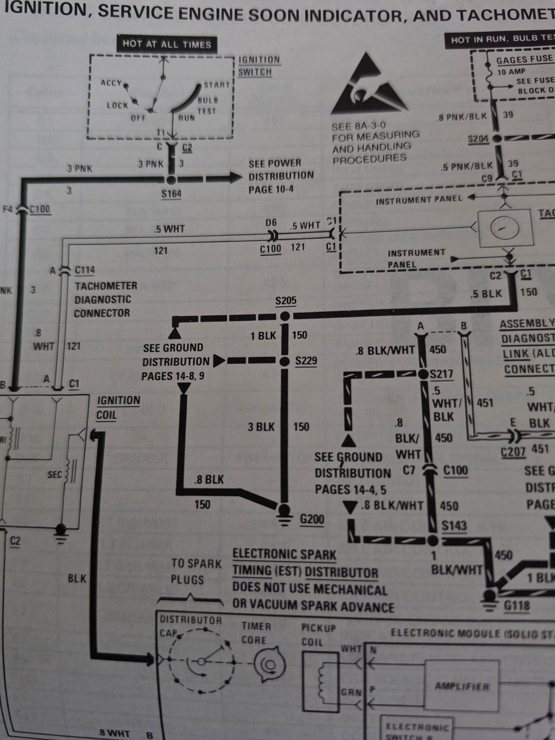

I have a 91 Z/28 that had a factory 305TPI.. I swapped the old engine out and built a 383 TPI and replaced the factory wiring with this new Fitech ultimate TPI... I am having two problems;
1) I cannot seem to get the speedometer to work. Apparently the 91's didn't have the vss buffer box, I've tried wiring the speedo output from the Fitech directly to the speedo cluster input wire.. Still nothing, has anyone on here had any experience with this system on a 91 Camaro ?
2) I connected the tach output wire to the white wire coming into the dash connector and it doesn't work either...

I have one in my 92. The tach works fine for me but that's because the ecm has nothing to do with it. Wire straight from the coil to D6 on the C100 sends it to the tach.

Tech support helped me with the above but they gave up on me with the tach output from the ecm. I ended up wiring the white wire off the coil straight to the tach and it worked just fine.
