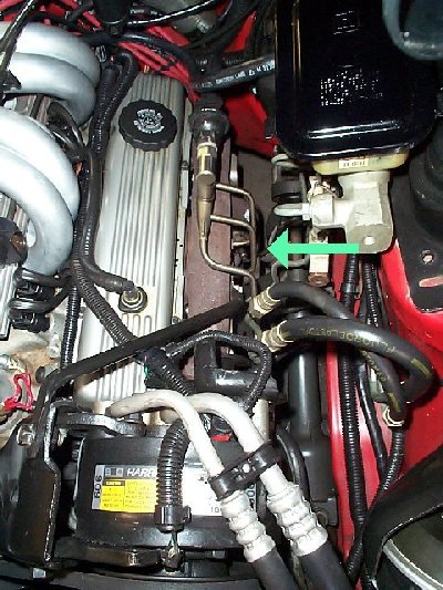

Ok, maybe i'm an idiot, but i can't find the damn O2 sensor!!??
Where is it? haynes says you can get to it by just lifting the hood and makes it sound easy, but i can't see it. Do i need to get under the car, plus haynes only shows a v6, mine is an 8...is there any difference? Please help me on this

look on the drivers side exhaust pipe just under the manifold connection.

The sensor is on the left side of the engine, in the exhaust pipe as others have described. It should be visible and accessible from the top side. You may need a box end wrench to break it loose, and it can be done from the top side. Penetrating oil is a big plus for getting them loose, and it always helps to apply penetrant a few days in advance and wet the item down every day to allow it plenty of time to work into the joint.
Anti seize is a must.

I used a oxygen sensor socket - how the h3ll do you use a box end wrench??!!!???
I spend all morning yesterday trying a damned wrench - finaly gave up and barrowed a special socket from autozone (hey - you get your deposit refunded, who cares!)
