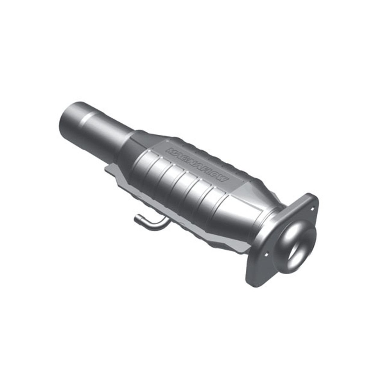

1985 to 1987 Pontiac Firebirds with TPI engines have a horribly restrictive air induction system. You need to swap all of it over to a 1988/1989 style air induction system with a K&N air filter. That thing is killing 5 to 10 HP & FT-LBS TQ.
The factory T merge pipe coming off the exhaust manifolds and going into the cat convertor is horribly restrictive too. It's killing 10 HP & FT-LBS of TQ.
The factory GM "AC" cat convertor on High Output single cat exhaust systems like your TPI Firebird has is NOT restrictive unless it has became restrictive over the years. The Magnaflow cat will easily out flow it though.
Both of these are FREE shipping in the US & Canada and are 20% off with the coupon code. This setup flows like gangbusters and is a 100% bolt in and fits like a nice Isotoner glove fits your hand. They are made of stainless steel. 304 SS for the cat convertor body and 409 SS for the Y-pipe.
Yes the cast iron manifolds suck but no where near as bad as the ones on non H.O. exhaust systems. Yes your car will still have a "Peanut" cam. It sucks monkey b*lls.
I'm hitting the low hanging fruit here. All of this stuff is easy to change and hurts nothing but your wallet.
Magnaflow 16450 - Camaro/Firebird Front Y-Pipe
Magnaflow 93441 | CHEVROLET CAMARO/PONTIAC FIREBIRD | Catalytic Converter-Direct Fit | Standard Grade EPA

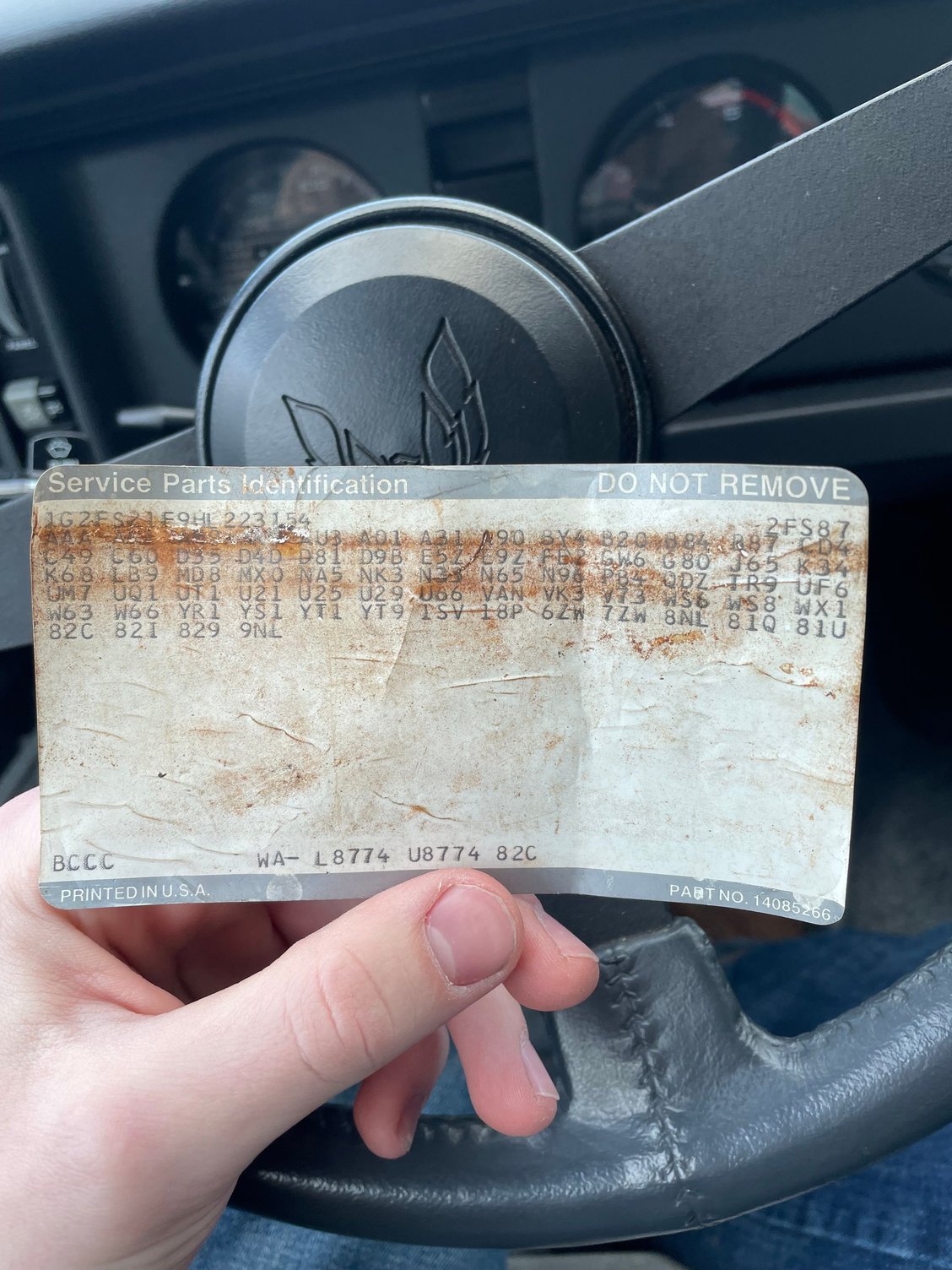

Is your 87 Formula a hardtop with J65 4 wheel disc brakes? Does it have a 140 MPH speedo and a 6k RPM tach with a 4500 RPM yellow line and a 5000 RPM redline?
Better yet just post a picture of your SPID label with the RPO codes. Try to get it in focus and of the entire label.

Old Mar 26, 2025 | 11:05 AM
Blarfy's Avatar
Joined: Jan 2025
Posts: 29
From: Wisconsin
Car: 1987 Firebird Formula
Re: Power mods for my bone stock 305 tpi
Yes.

As best as I can figure it there could be up to 668 87 Formulas built with your powertrain/drivetrain combination. But I can't tell if there were any 87 Formulas built with LG4 engine with J65 4 wheel disc brakes. If there were then it would be 668 minus the number that were built with the LG4 and J65 4 wheel disc brakes and that would be how many were built like your car powertrain/drivetrain.
For 1988 this was easier to do because you couldn't get J65 4 wheel disc brakes or a Borg Warner "Aussie" 9 bolt rear end with the L03 TBI engine. So I could brake it all the way down to 158 Formulas built with this powertrain/drivetrain combination.
Basically your 87 Formula is a Formula 350 minus the 350 B2L/L98 engine, the hot cam, and KC4 engine oil cooler.
In Chevy Camaro world your car would be a 87 IROC-Z LB9/MX0/MD8 G92 Performance Axel Ratio car.

If your 87 Formula wasn't Bright Red with a Medium Dark Grey interior I'd be trying to buy it from you. My least favorite color combo and I'm stick to death of it too.
Old Mar 26, 2025 | 11:36 AM

Huh. Very interesting. Where do you pull this data from? I'd like to look into it myself too.

3rdgenformula.com - Main Menu
I have also edited some of my replies above.
It takes some creative math and knowledge of what options were and weren't available together each year and model to figure the numbers out.
There is no RPO code or name for what your 87 Formula is. It had to be ordered and not ordered with certain options to get what you have. It doesn't mean your car is "valuable" it just means it is rare. You had to not order RPO CC1 T-tops and order RPO J65 4 wheel disc brakes.

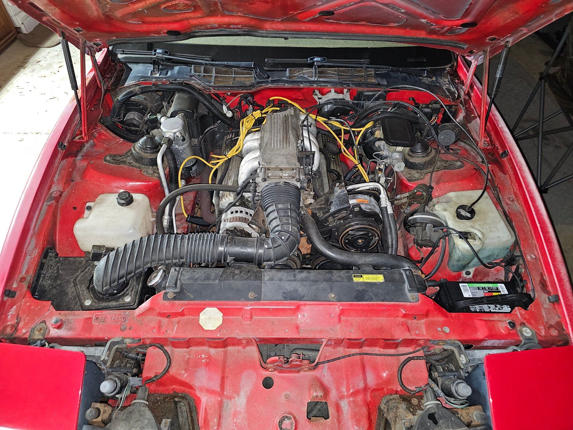

Originally Posted by Blarfy
I've gotta look into the other things you mentioned, I was under the impression that those systems don't fit well. You make it sound really quite simple though.
This is a picture of a 1987 Trans Am GTA with a SLP cold air induction system for 1985 to 1987 TPI Firebirds installed. The ducting used in this SLP system is the OEM GM ducting used on 1988/1989 TPI systems with the addition of a riveted in air flow straightener in the duct after the mass airflow sensor and before where it makes the 90 degree turn to go into the throttle body. The octagon STOP sticker on the core support is the K&N equipped air filter warning sticker.
This SLP CAI system is similar to the one the made for the 1988/1989 TPI Firebirds but with extra stuff to do the 85/87 upgrade to the 88/89 style air induction system.

I see. How does one like in your photo help airflow when it's routed back into the same spot? Would one like this where it has more room to breathe not provide better airflow?
setups like this have you sucking hot air from the engine compartment vs sucking in cold air from the outside like the previously posted system.

10-4. That makes sense. Don't suppose you've got a link to that other style? I can't seem to find one outside of this thread. Maybe I'm looking for it wrong haha

@RedLeader289 and it looks like azz when you pop the hood. It jumps right out at you and looks like a boy racer dumb azz teenager fart can r|cer mod.
These are MY opinions. It's your car. You can do whatever you want with it. You paid for it and it's your money that is being spent to modify and upgrade it. You can put a 454 big block with a 671 supercharger sticking out the hood and put the body on a 4x4 monster truck frame and go mudding in it if that's what makes you happy. I'd much rather see a person enjoy and use their 3rd gen and make memories in it with their friends and family then see it sit in a climate controlled garage to get wiped down with a virgin cotton baby diaper with your left hand while you have a bottle of baby oil for your enjoyment with your right hand with the lights turned down low and "Let's Get It On" by Marvin Gaye playing on the radio.
Your 87 Formula looks to be in very nice condition, very stock and unmodified. With your car being somewhat "rare" I would modify it for your enjoyment but keep it stock appearing at first glance. Have it look like that's the way Pontiac built it and with some tasteful vintage "Day 2" mods and modern updates.
That style of air induction system came on 1988/1989 TPI Firebirds. That is where you will find one at. The SLP cold air box is part of the SLP kit. I just used a picture with it installed as an example because it is a picture of a 1987 GTA and it's Bright Red too same as your 1987 Formula. LoL
