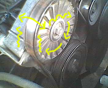

Example 2 --> This peice is raddling sideway very slighty its a real pain the way it jidders, its kinda loose I guess, I dont know how to fix this problem.
heres a picture.

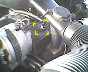

Example 3 --> I have a small leak, not sure what it is! I think it was oil actually, its a small hose and it has a leak..
in the picture its right under that big hose as you see.. im pointing to it, and I also outlined where its located in the engine area.

well...that leaking house appears to be in the area of the power steering unit. power steering fliud is a oil and is like a dark red colour. so check the hoses there for cracks and make sure the they are on tight (check the clamps, etc)

Example#2
Take off your belt and try to move the pulley by hand,if it has anything more then a tiny bit of of up/down or side play it will need the bushing/ bearing replaced. I would go look at mine to see which it has but it's kinda dark out. It should be fairly self explanetary once you take the belt off.
One more thought try to see if you can tell if the play is located between the pulley and mounting shaft or if it is the shaft itself that is moving. Hope this help's you out SR
