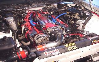

Get ready to rev that puppy! I've reved mine to 6500 a couple of times and it felt like it would easily pull strong to 7000. I just recently had my tranny built and went with a 2500 stall. This was before the LT1 intake. Now I wish I had at least a 3000. Just upgraded to 3.73's from 3.27's also. I did lose some torque down low, but it makes it easier to launch now.

hey steve I got a ? for you about your cold air intake. What did you use for that shiny pipe? is that a exuast pipe or what is that? Also what did u do to attach it to the throttle body?

It's 316 stainless pipe that the pipefitters use in the shop at work. I purchased some stainless weld 90's from Pac Stainless and had the guys weld it up. I used a 4"x3" rubber sewer connector from Home Depot to connect to TB.

What would you recommend me doing. Im in the process of doing the lt1 intake, but im gonna do a cai set just like you have. Also what did you use to attach ur MAF sensor. I see those red thing, but what are they and where do I get them?

If you do the LT1 intake swap, and a hot cam, you will need some prom tuning. I burn my own and can tell you that things have changed drastically. I'm going to dump the MAF and go with SD. The red things are turbo hose connectors from www.hosetechniques.com. They are kind of pricey, but look good.
