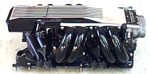

i siamesed the entire length of the base. haven't put it on the dyno yet. but no loss of rpm. there is another post where a guy did it and posted a dyno sheet showing what happened.

will have it on the dyno soon. so far it's been 5000 with no drop off in the seat dyno.

when i did the porting on the plenum, i left all the holes the stock diameter. because i am using the stock runners and TB. but you remove the wall from the front right where the TB mounts. you'll see the hole on the left, at the bottom of it, i took then wall out. on the right the wall is still there. so you can see before and after. so far with what i've done ( ported l98 heads, plenum, base, lt1 cam) and shifting at 4600 i gained .5 seconds. went from 14.91 to 14.46. i was praticing my lauches at the track because i had new tires on. so, i forgot that i needed to shift higher. my 60ft before the porting and cam was 1.964. after i did a 2.000. so no loss of low end. will need to shift at 5700 to see if i pick up any more.

no. i left the entrance and the runners alone. just to ensure sealing. plus couldn't get anyone with an aluminum welder to siamese the runners. metal is too thin to do it. so from the outside the intake looks completely stock.
