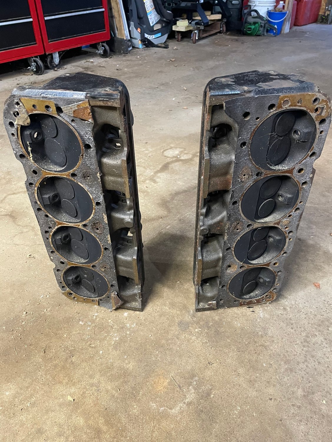

Do you wanna sell the 217 heads I have 083 heads that just got done in the freaking shop resurfaced and 5 way valve job live in ny

well one has been welded so it clearly cracked at some point so but do you wanna sell them im looking for a set that's all

Yes, I’ll sell them. I’m new at this forum, how do you do a private message to share contact info?
