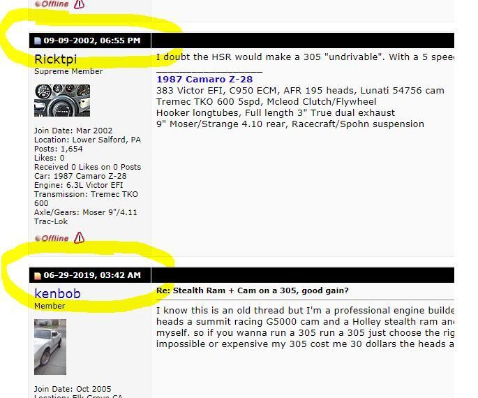

I know this is an old thread but I'm a professional engine builder and if you can't make power with any Chevy V8 you don't deserve to drive one I hate when people say get a 350 I'm running a 305 with 305 vortec 520 heads a summit racing G5000 cam and a Holley stealth ram and I make 347 horsepower and 360ft.lbs and I built the 305 to whip every 350's *** flat out I'm also running a WC T5 I built and a 3.70 9-bolt posi I built myself. so if you wanna run a 305 run a 305 just choose the right heads world products and trick flow specialties make heads specific for small bore Chevy's and even Chevy performance made a 400 horsepower 305 it's not impossible or expensive my 305 cost me 30 dollars the heads another 30 so all together I'm just under a grand how much did your 350 cost?

So it's been nearly 17 years. Since Ricktpi's post, children have been born and graduated high school. 935 million people have died. George Bush was in his second year. The iPhone was not in anyone's imagination. The iPod was six months old. Facebook didn't exist.
