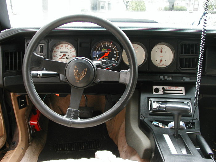

i had my box right behind my headlights cause it is supposed to be the coolest spot in the engine bay......but man that thing gets HOT!!! so i mounted it on the inside of my car, on the drivers kickpanel. as long s you dont have a stick, its fine. i think it looks good there, great locatin to run wires, and most importantly it doesnt get hot.

Does your car have A/c? I have mine mounted on the passanger firewall.
