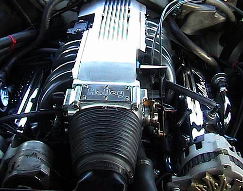

I just finished the swap. At first I just dropped in a 350 short block I'd built. It was a all new roller cam motor and I was disapointed. Thats when I started hunting and found this site. There are a lotta stuff you can do that really don't cost a whole lot but you need to do research and have some mechanical ability. If you want to spend the time here are the tips I have to offer. I rebuilt mine again in lss than 100 miles.. This long *** post is just a few...
Number one deal is to make sure that you know what block and heads you want and need to run to keep the right flywheel combo. Think of where and how you'll use the car and what would be the best for you.
Then consider this goal. Moving as much air, air- fuel and exhaust as effecently as possible in as large amounts as possible as unrestricted as possible.
Free or cheap Horsepower..
Adjustable fuel pressure regulator : I made my own, I took the cap off the top and made it more concaved actually moulding the lid outward slightly. Then I drilled a hole in the center and welded a 6mm nut (10 mm head size ) installed a small bolt that would clear the plentum and put it back together, I found it ness to silicone a washer smaller than the bolt threads on top of the spring on the inside of the reg.. Worked perfect and Raising the fuel pressure to about 48 at idle and 53 on hard acell on the 5.0 injectors seemed to work fine in my case. Cost me nothing. if you had someone else weld the bolt on it would still be cheap.
Port the heads. Cost some money here in cutters, griders ext... I actually changed to early heads which you should have anyway. Find out what diflection is and eleminate it as best as you can for a free flow of air and exhaust..
Now that you have the port tools.. Find madmax's post on porting the intake, plentum and runners. and do those too. Try to fit headers into the budget.
Cam, chose one that works for your ability. You don't need a cam that pulls to 7 grand if you'll never see it. I am running the same cam as the ramjet motor runs. It was cheap and works good for me. Then I added new roller lifters picked up on ebay and 1.6 rockers from Summit. It works pretty well.
I know I don't have the fastest car out here but my 90 formula came with the factory dual exhaust 5 speed ect and it was pretty fast for a stock 305. The first time through with the new 350 I was not happy and I had the same cam less the roller rockers.
Buy books and read.. study and print stuff of of here.. Take your time..
* Ported and Polished Early style Cast Iron Cylinder Heads and Manley 2.02 and 1.60 Pro-Flo Valves.
* A Ram-Jet G.M.P.P. Roller Cam with 1.6 Harland Sharp Roller Rockers.
* Homemade Adjustable Fuel Pressure Regulator.
* Simease Ported Plentum.
* The Intake is modified to fit the heads then Ported and Polished as in the thread from MadMax.
* The Runners are semi Simeased and all Gaskets Matching.
* A 52MM Holley Throttle Body.
* The Balanced Rotating Assy has 1.25 Dome Forged Pistons, CR = 10.4 - 1.
* Edlebrock Chrome T.E.S. Headers.
* Twin High Flow 3" Cats with 3" Exhaust tubing Replicating the Original Factory Dual Exhaust.
* Flowmaster Cat Back System.
