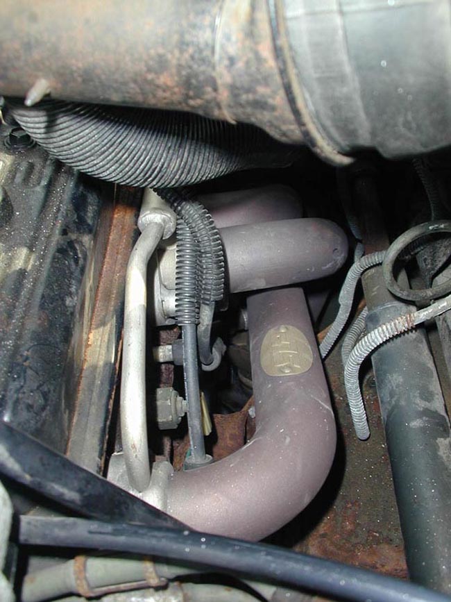

Heres a pic of my 1 3/4 SLPs.

note the lack of rust(thick flaky), but not bright and shinny like a coating. That's stainless steel, I don't think anyone else makes SS headers so.
And the SLP tag tack welded to the tube, sorry I thought mine was welded more towards the collector end.
