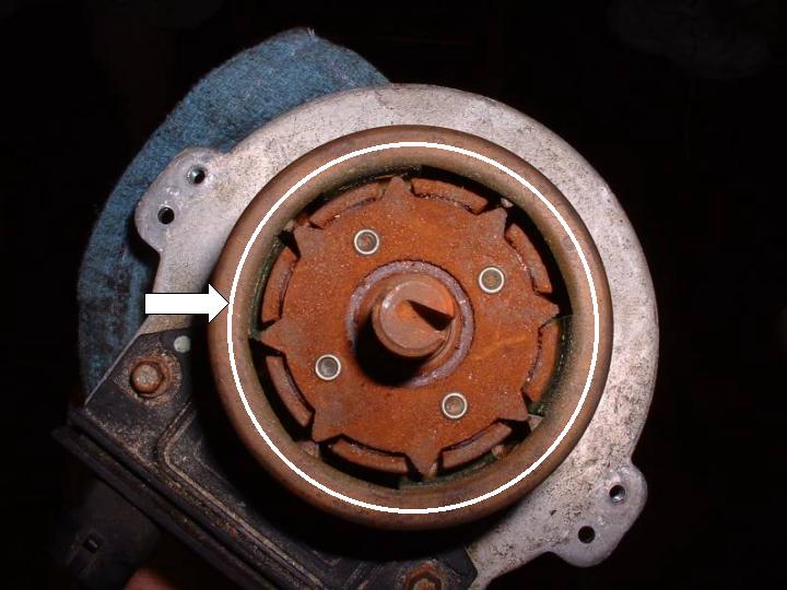

OK, what happens if the part shown in the picture can move? I can rotate it back and forth about 1/4 to 1/2 an inch. If it's not supposed to move, what do I need to do to replace it?

Try this. Look for my post. It's a page I pulled from the Helms manual on code 42.
https://www.thirdgen.org/techbb2/sho...&highlight=est
