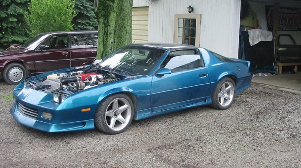

well i got the 19lb. injectors and im havn a PROM burned for me so HOPEFULLY everything works out once i get the PROM back and we put it together:lala:

so i sent the prom out to be burned for my correct settings...well the dude who was gonna do that called hypertech and ran some part numbers...turns out the chip i got in the computer was a stage 3 for an 89'vette so i called the gent i got everything from and he told me it was a cali emissions memcal for a 91-92 TPI 5.7L camaro...so who knows who's right i dont really care but he's sending me a memcal tomorra hopefully for a 5.0L TPI automatic so im hoping that'll solve most my problems cause it if doesnt im gonna cry..heh
nice looking car, do you have a hood for it? lol im assuming its off for the intake swap...

the first lots of times we tried to start it...and basically that gas sat in the motor and ended up draining into the crankcase and eating all the oil out of the bearings and ****...now it makes a reaaaaaaaaal loud knock sound and it has no power...its done for so far thats the only theory we can come up with on why its smoked
Old Aug 17, 2003 | 04:24 PM
MILT's Avatar
Posts: 392
From: Minneapolis, MN
sorry to hear about your troubles...
a quick question--what type of rims are those, and what size tires are you running? They look very nice.

1. Factory Tpi Only like cams that are 112 lobe seperation and a intake duration no more than 220.
2. The chip would have to be burned to the specs. of the engine.
3. 305 tpi used 19lbs injectors and 350 tpi used 22lbs injectors the mfg. of the injectors is Rochester. The two part number are 17080101 and 17080102.
4. If the engine is modified you will need to have a chip made.
I bought all my high performance stuff from TPI Specialties.
5. Make sure the fuel is set at 43.5lbs for a 22lb injector.
6. Ajustable TPS sensor (0.50 volts)
7. Calibrate the IAC valve.
