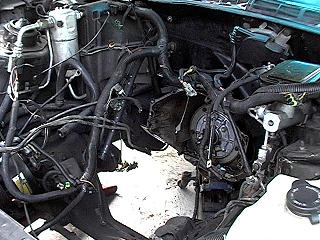

this is the empty engine bay with all the old wiring harness in it...
I had to get a pin out diagram to find out where the A/C relay and fan control relay and park/neutral switch plugged into the ECM so i could use these for the commander 950's ecm. there were a few pinouts I forgot to find so now im chasing down A/C compressor wiring and knock wiring diagrams.
