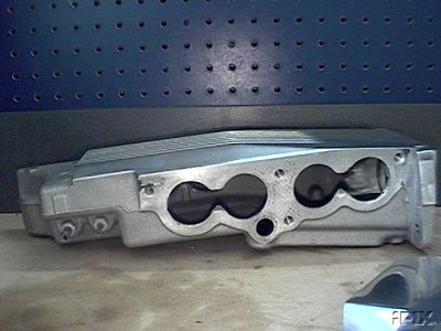

here's some pics....

Old Aug 8, 2003 | 07:44 PM
72LT1VETTE's Avatar
Posts: 323
From: CLIMAX, GA. USA
Car: 1972 LT1 Corvette
Engine: 350 HO
Transmission: M22 Heavy Duty 4 Spd
Axle/Gears: 336
No mods needed. Just bolt the sucka on.
