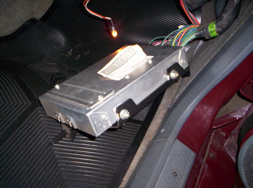

I just had my ECM out today and noticed I was completely missing the MAS. I still have the original 870 ECM so I know I am supposed to have this thing. I looked every where under the dash (thinking it might have broke off) but it is not there. Period.
What will the car do without this module?
Here is a pic of the ECM.

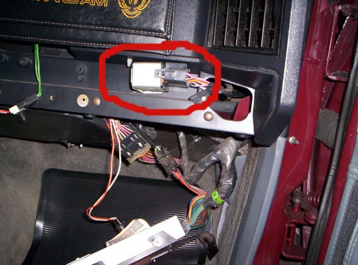

I did find this module mounted here though. What is this?

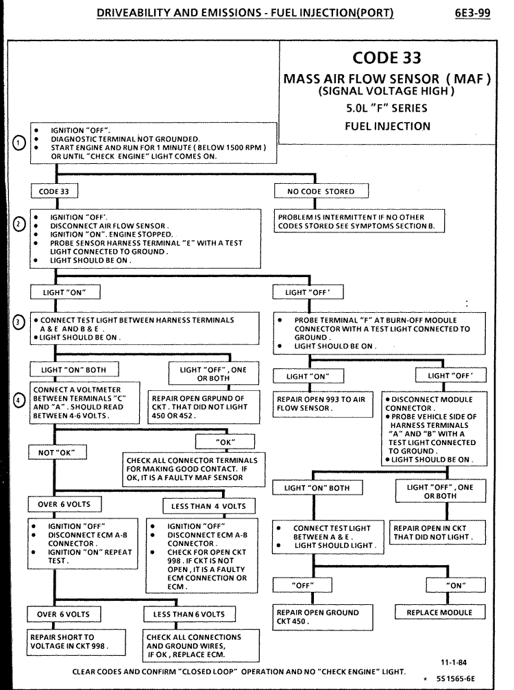

They only came on the 5.0L TPI engines. Check this trouble shooting chart for the MAF.
Attached Thumbnails Missing burn off module (MAS) on my 85 T/A-q22.gif

Old Jun 3, 2004 | 07:44 PM
ss85tadude's Avatar
Joined: Oct 2003
Posts: 528
From: NorthEast GA
Car: 85 Trans Am
Transmission: 700-R4
Well I found it. It was mounted way up into the dash, I could not even find how to unmount it. I guess you have to pull the dash pad off.
