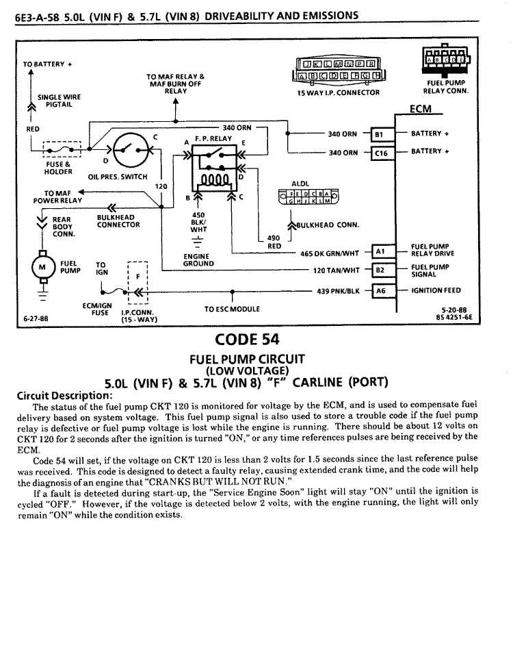

Hello HamSpiced,
Code 54 is low voltage to the fuel pump circuit.

Originally posted by HamSpiced
Hey man,
Yea i know thats what it is... but i dont understand how to fix it....

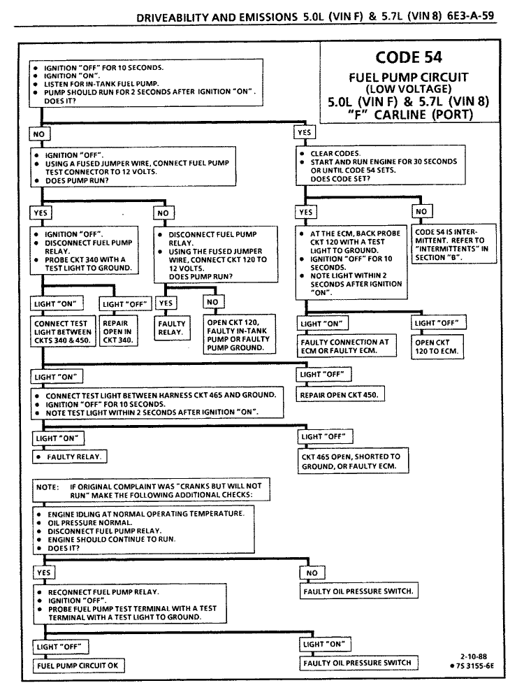

If you want, I can post the troubleshooting tree for you to check your system.

My code 43 on my first 1991 Z28 305tpi was a bad knock sensor.
My friend had a code 54 on his 1992 formula 5.0tbi. He had a bad fuel pump relay.
Best bet is to go through a diagnosis flow chart to help track down the problem.
yes please do... i tried to search and and i couldnt find it.... go figure...
Old Jul 5, 2004 | 09:55 PM
Trickster's Avatar
Posts: 6,127
Likes: 12
From: conway, s.c.
Car: 1989 Iroc-Z
Engine: 5.7L TPI
No problem dude, here it is and good luck.
Old Jul 5, 2004 | 09:56 PM
Trickster's Avatar
Posts: 6,127
Likes: 12
From: conway, s.c.
Car: 1989 Iroc-Z
Engine: 5.7L TPI
Page 2

so far everythings checked out good.....
im starting to get confused.....

ok so i replaced the cap rotor and plugs hoping it was just somethnig like that...
well of course i was wrong... i can get the car to occasionalyl start, and i can get it to do a low accelleration from 1k to 4k and back down, however i cannot tap the gas....
provided is a video of me doing just that...
http://s92002946.onlinehome.us/Videos/Car.wmv
a slow 4k climb and slow back down again, and then a tap of the gas pedal.
it dies completly..
if the code 54 is what is causeing it, and im getting a headache reading the diagrams and trying to understand what a ckt 465 or 450 etc is what are the most common "gone wrong" things that cause this?
