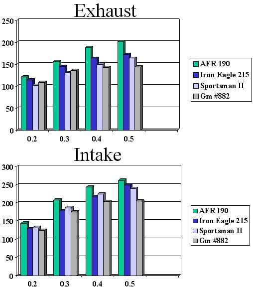

Then I have your answer.... $1250 including shipping, cheapest place to get em. I ended up paying $1600 for mine after some upgrades but the difference was tremendous.
http://www.jdsperformance.com/index....nmake=all&pg=1
AFRs are the only way to go, all my vehicles will have them....cept the wifes Saturn
Look epecially at low to mid lift, and the huge difference in exhaust
Edit: I know they dont make 190s anymore, 195s are basically the same...
