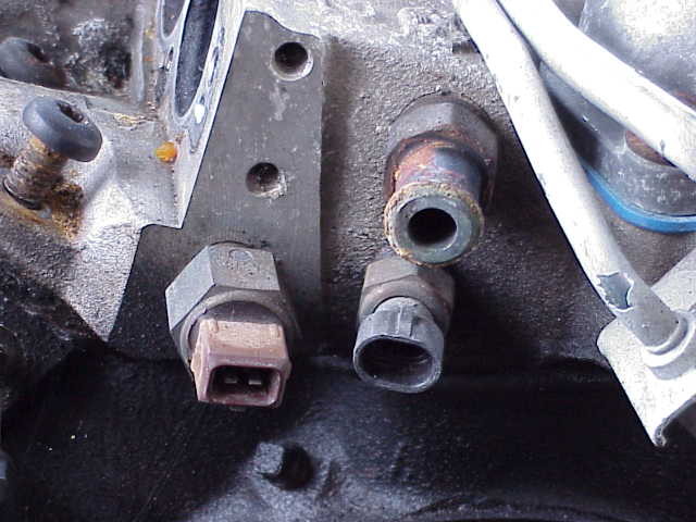

Originally posted by camaro_60181
where is this cold start switch? Is there a way to test it. I don't want to just throw money at the car in hopes that it might work.
Here is a picture of the cold start switch and there is no way to test it. The cold start switch is the reddish colored connector on the left and the black colored one is the coolant temperature sensor.
Attached Thumbnails cold start problems(not cold sart injector)-front-intake.jpg
Old Sep 29, 2004 | 06:34 PM
camaro_60181's Avatar
Joined: Feb 2002
Posts: 497
From: Villa Park, IL
Car: 1986 Iroc z28
thanks trickster....I guess I'll have to give that a try.
